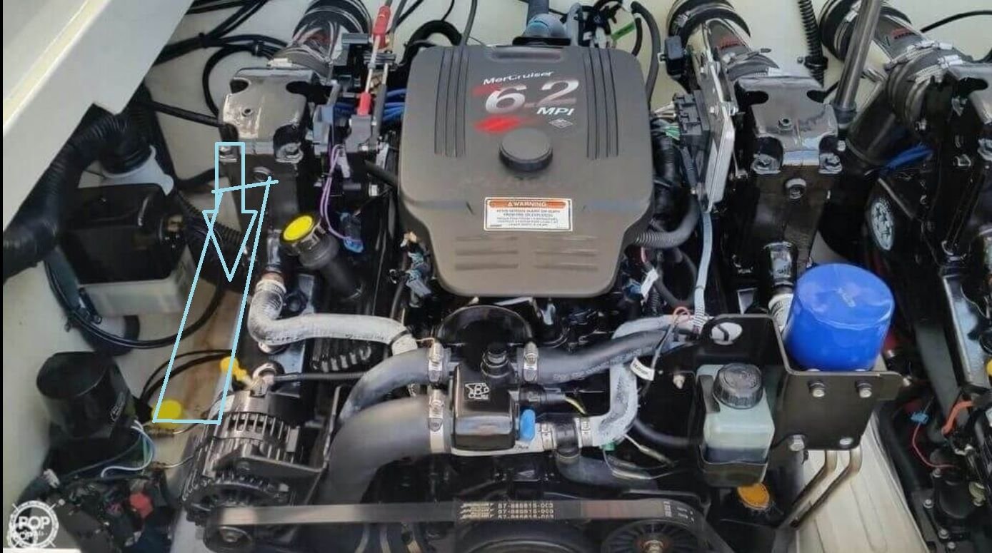

So i looked at a '02 292 yesterday, boat is extremely clean, 400 hours. I noticed one area of concern down on the bottom outside on both port and starboard sides of the boat, the paint or whatever they use over the bare fiberglass is cracked and coming off in a few spots. I didn't take a picture of this particular boat that i looked at but in the pic below this is the area that its peeling up. The boat in this pic where you can see its discolored is the area that peeling up on the boat i looked at. is this a common on these boats? is this a problem or something that i just scrape the loose paint off and repaint that area and call it good? There's no woods in these boats so i wouldn't think this is any sort of a structural issue.

Common issue - or at least my 292 has this. it's been peeling up, seem to just be paint chips. boat's 20 years old. If I get another 5-10 out of it, I'm fine w/that. I can't imagine it would be structural or any real issues... I just hit it w/soap and a high pressure hose. Water gets stuck in here and sits. the white parts then flake off.

Pretty sure all Fastechs have that issue, my 353 is as you describe. The drain is above the floor surface, so it retains some water/liquid.

Common and total non issue....
