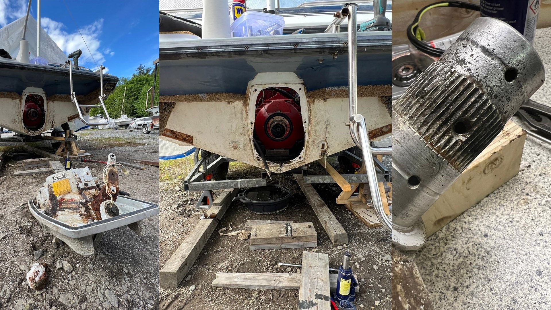

Some pictures.
I finally got the shield and sterndrive removed.
Started to disassemble the shield. Tiller fork was superstuck and I had to use a small sledgehammer and a bunch of WD40. The fork doesn't look great. I wonder if I should let a friend work on it with his lathe. Then I would also need custom bushings..
The tilt trim arms(?) are still connected to the shield and the dowel pins have not decided to come out yet. Will try to persuade them later this week. After that I'll start sandblasting a few parts and get them ready for new paint.
The swim platform will be removed during the the weekend or maybe I'll pull the engine first.

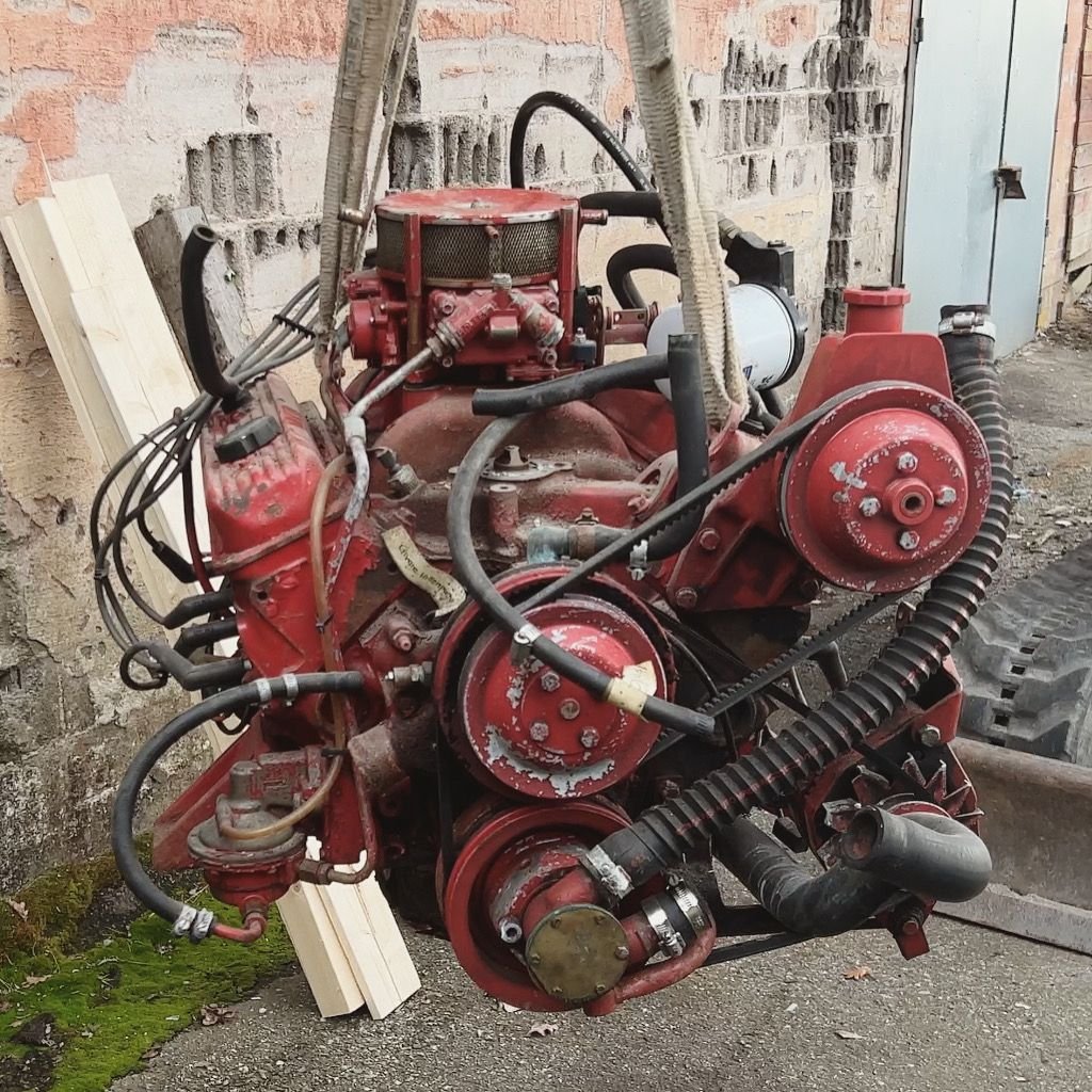

Engine will get some tlc
Volvo penta
