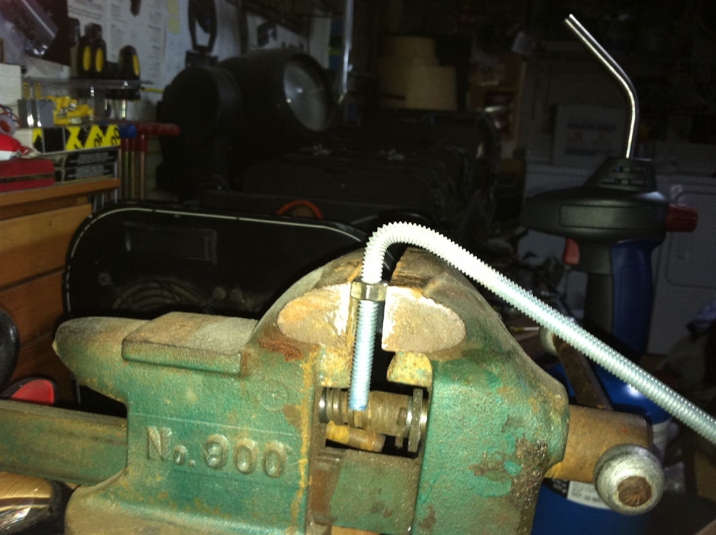

For my next trick i will try this:
Using a stainless steel piece of all thread that is a little smaller than the original bolt bent it into a curve or hook then hook it around the thick washer that has the bad threads on it then insert that into the boat and come under with a washer and nylon nut. once I have curved this piece i can cut and grind it to fit????????????

Old 04-02-2011 | 05:24 PM
off roading's Avatar
Joined: Apr 2006
Posts: 54
From: toledo ohio
Try getting a metric self tapping bolt next size up and screwing it in.
off roading is offline
Old 04-02-2011 | 05:41 PM
leonard's Avatar
Joined: Apr 2008
Posts: 125
From: San Diego, CA.
thats what i'm going to try right there!

you could also go with a flat 1/4in think peice of steel,,,placed inside the rail that is drilled and tapped for any size bolt you need,,,kinda like a nut inside the rail,,,made out of the piece of steel

Are the rails ss? Is so be careful with jamming anything metric or self tapping in or you're gonna have a locked up mess.
Stick with me on this. Take a short piece of all thread, perhaps 3/8 and jam it into your hole from inside the boat. Drill and tap the rail from the side for two 10-32 grub/set screws. Tighten them till they mar the threads. Pull the all thread out, drill a hole where each set screw makes contact through the rod, then reinstall. Use longer screws to lock into the holes and then put a nut on the inside and call it a day
