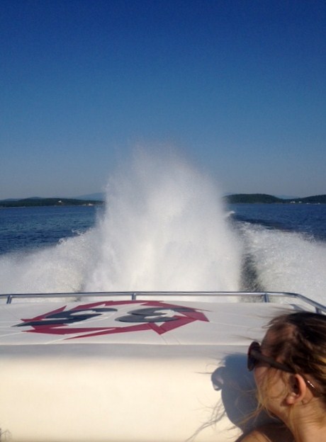

KWright 07-13-2012 09:16 PM
1 Attachment(s)
35 Fountain side by side hp500's Imco scx4's trim set at 4, 3 is level. Attachment 478653
