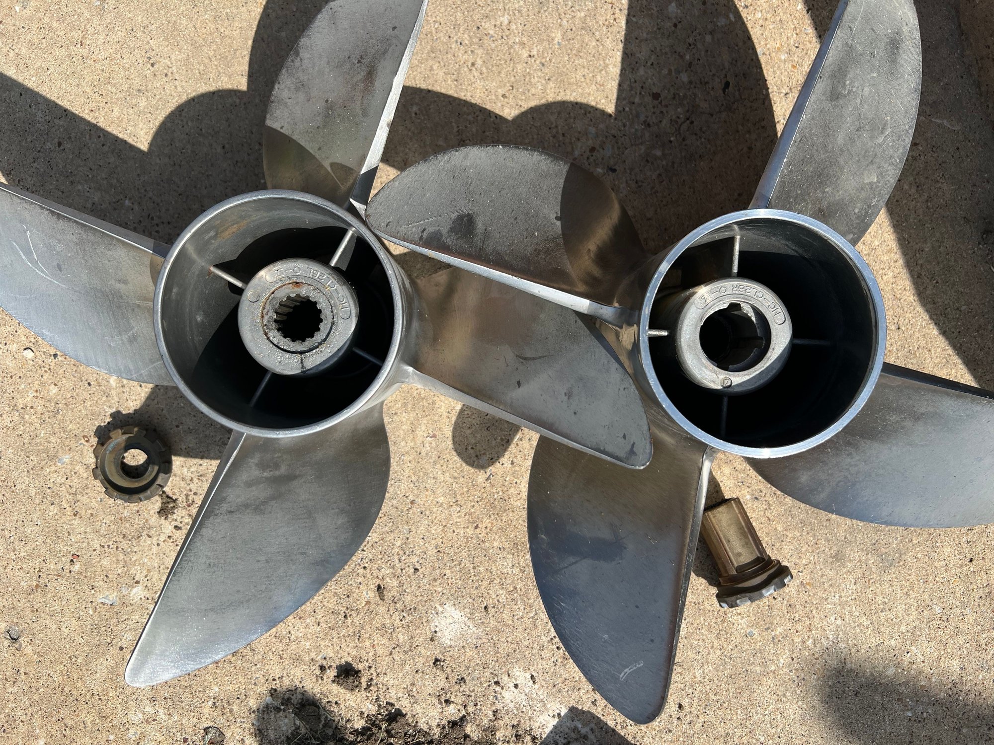

Old 07-14-2024 | 11:39 AM
Joined: Nov 2003
Posts: 375
From: Dallas, TX
I tried switching the direction of the props and gained all kinds of control! I'm still a rookie, but wow what a difference! I'd say 2x the applied force with direction control. I can move around the docs without touching my steering wheel. Backed into a tight spot without bumping the sides lol! Top speed is now 64 so maybe I lost 1-2mph. Well worth it IMO. Same 4500rpm max.
I slipped on the new out-of-the-box Hydromotives Q-IV (spinning in). I was initially shocked they have different hubs. wth? Then double shocked they have different pitch?? wtf! The prop with the splines has a shorter pitch. It was about 300rpm off at speed. They bit just fine though (didn't blow them out) so they might be worth sending off to be matched properly.
