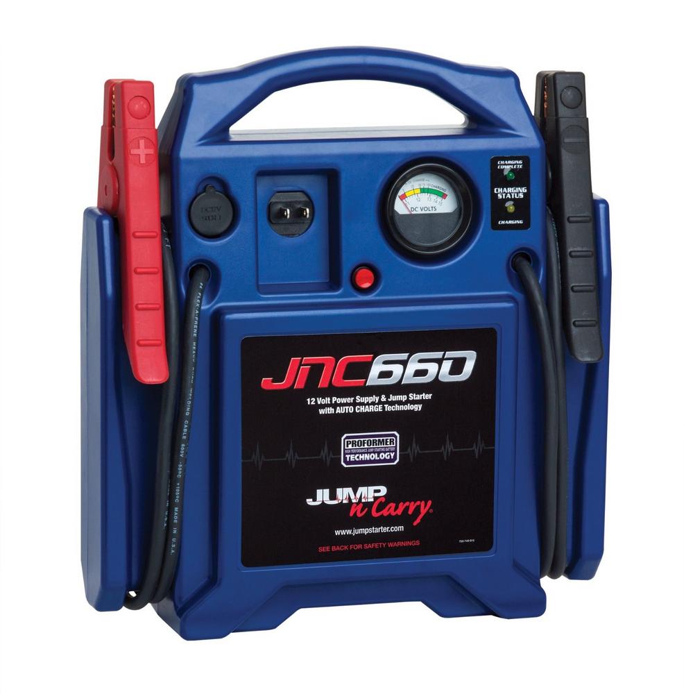

Jump pack is brand new and fully charged JNC 660 was told it is one of the best for the price and has more than enough power to crank , i will definately check the ground on that side, as always i appreciate your input.Thanks.

Every jump box I ever had was just a glorified motorcycle battery but they work in a pinch. +1 on all above comments, check your ground. I would also load test that battery, it will do the same thing if a cell is starting to go bad. Randy

Im in MN the only useful jump box is a 27 series deep cycle starting battery and 2ga wire to the clamps. Jump boxes are generally useless.
