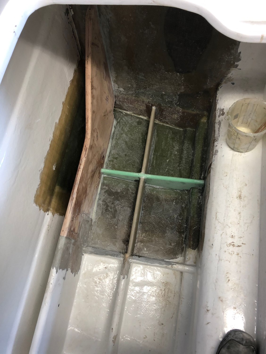

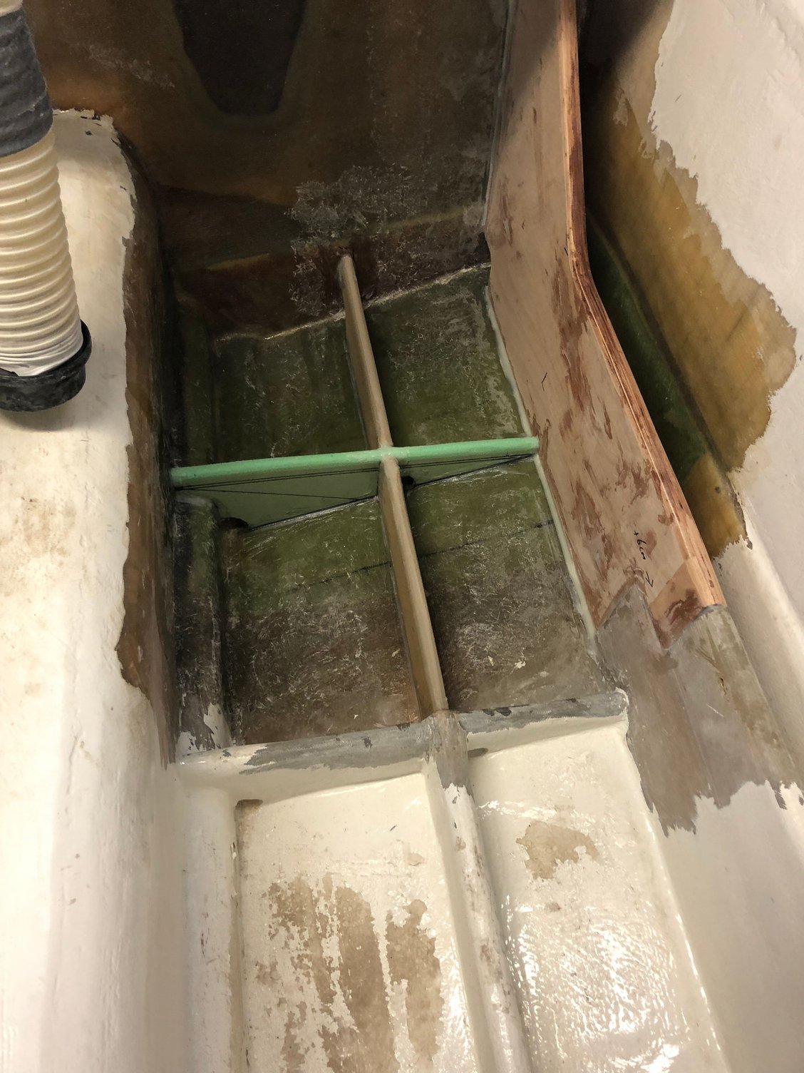

Update
Its been a long time but still working on it , notches are filled and boat is now being completely redone inside and out after that we can put back all rigging and windshield and start where we left a pretty long time ago
Notches filled whit waterramps
https://cimg2.ibsrv.net/gimg/www.off...68d968433.jpeg
Putting back all stringers and coring
https://cimg3.ibsrv.net/gimg/www.off...ac67248b5.jpeg
Putting back all coring and stringers
https://cimg4.ibsrv.net/gimg/www.off...97172b2d3.jpeg
Filled notches whit waterramps

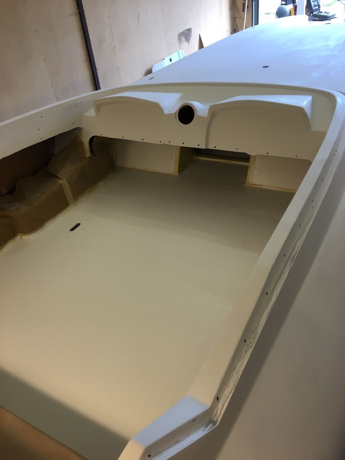

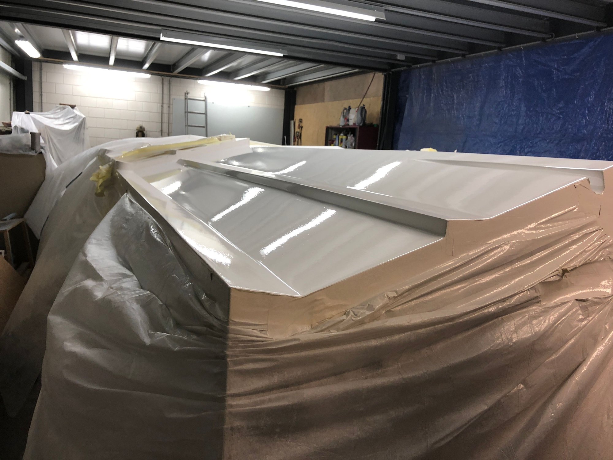

bor 10-07-2018 12:31 AM
Finally ready for paint , all epoxy primer sanded down , cockpit floor have new anti slip as Original had to sanded down to get adhesion , side gun whale have new paint and clear over the carbon and is all covered up so painter can walk in the cockpit to spray the dashboard and rest of the cockpit
Get here cleaned inside and out to get to the paint boothhttps://cimg6.ibsrv.net/gimg/www.off...cf20a74cf.jpeghttps://cimg7.ibsrv.net/gimg/www.off...74450d3b1.jpeg
https://cimg5.ibsrv.net/gimg/www.off...06a336698.jpeg
https://cimg8.ibsrv.net/gimg/www.off...11a5b8f57.jpeg
https://cimg9.ibsrv.net/gimg/www.off...bdd35c341.jpeg
