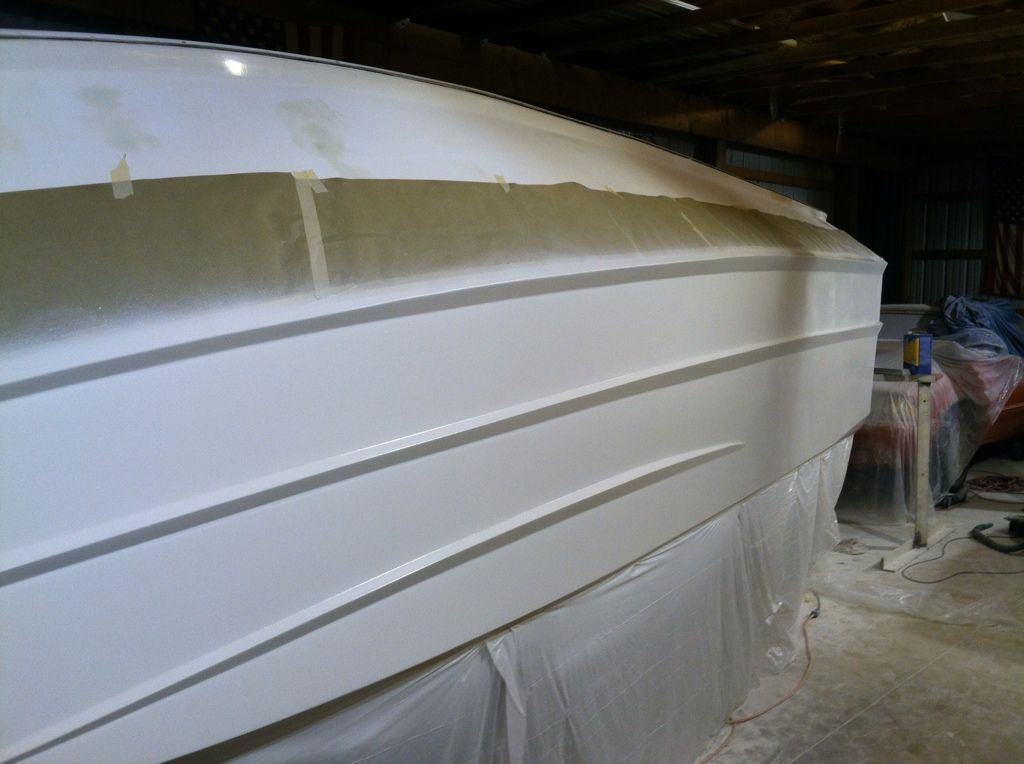

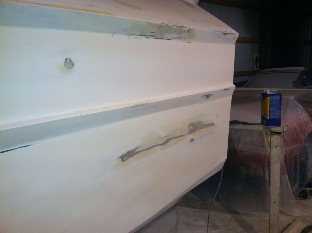

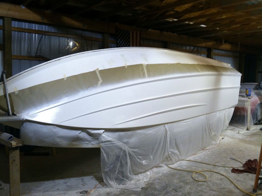

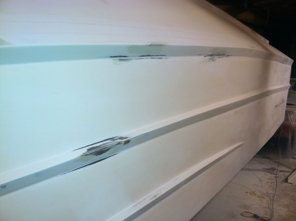

I did the best I could on my pantera. I built a rotisserie and filled all the gouges, blocked out the flat areas and sharpened up the strakes some.
After I was satisfied, I gelcoated the bottom.
Time will tell if the boat rides crispy and straight. I sure hope so.
