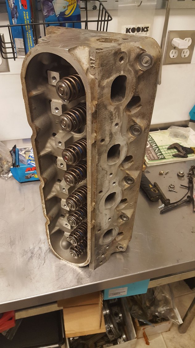

Springs setup on heads
https://cimg4.ibsrv.net/gimg/www.off...12af224fec.jpg

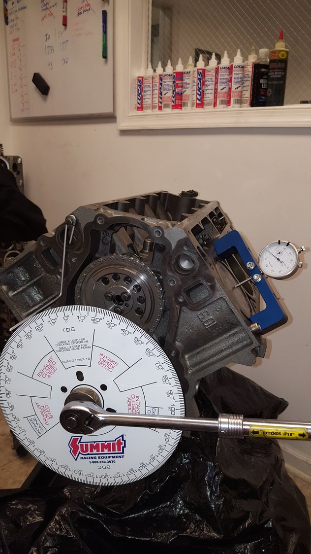

Cams advanced 7 degrees
https://cimg6.ibsrv.net/gimg/www.off...250bf802ef.jpg
