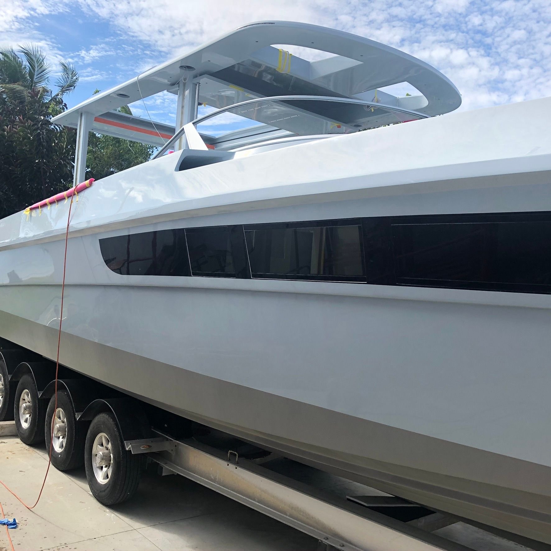

Finally more pics! Sorry I haven’t been posting
https://cimg9.ibsrv.net/gimg/www.off...a6216ba27.jpeg

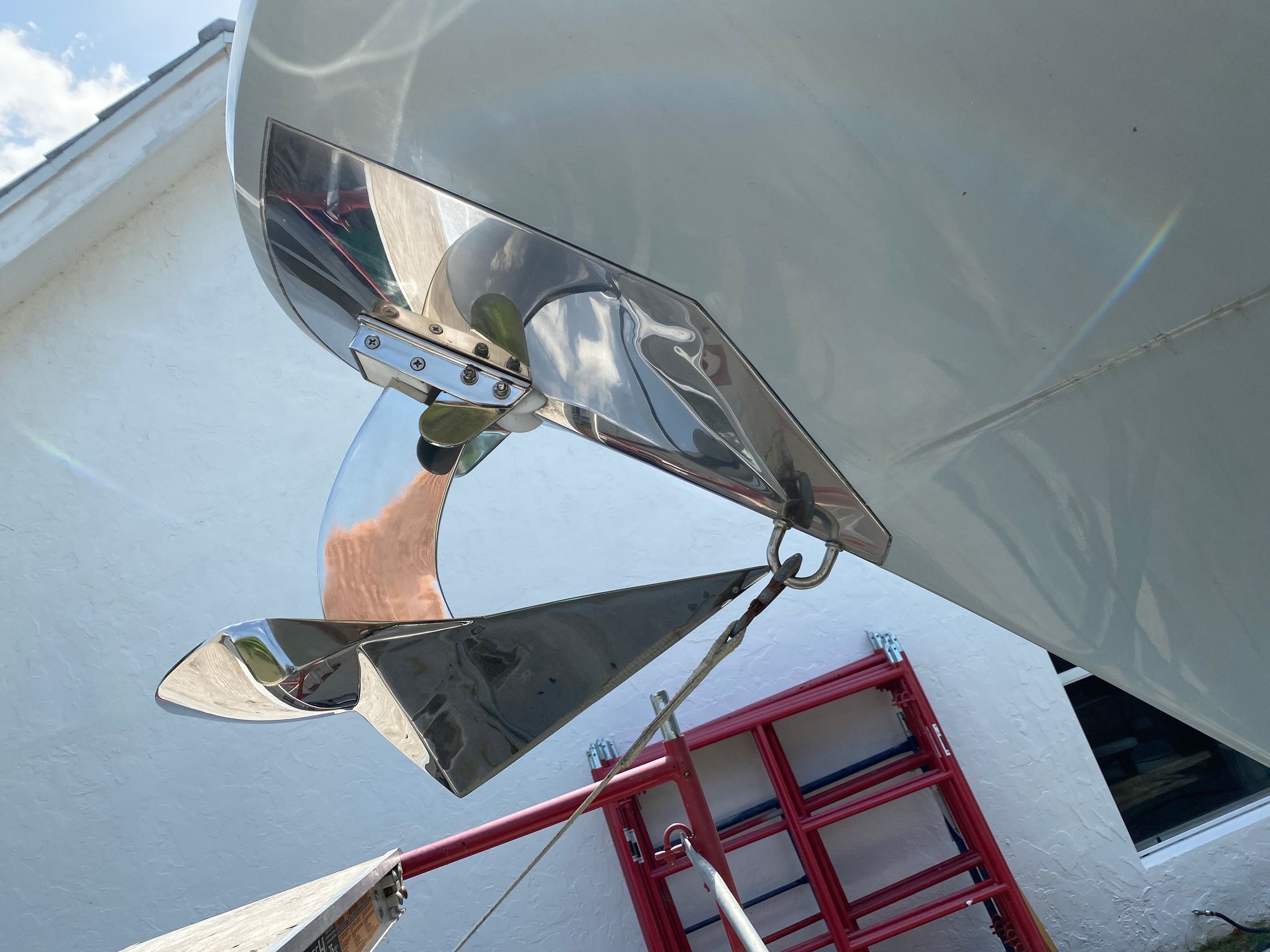

Anchor and winch finally in
https://cimg0.ibsrv.net/gimg/www.off...512e95604.jpeg

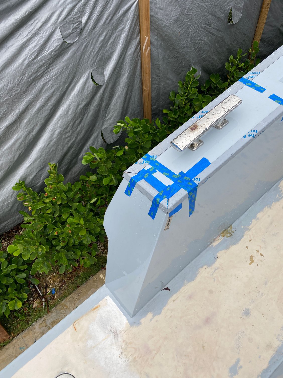

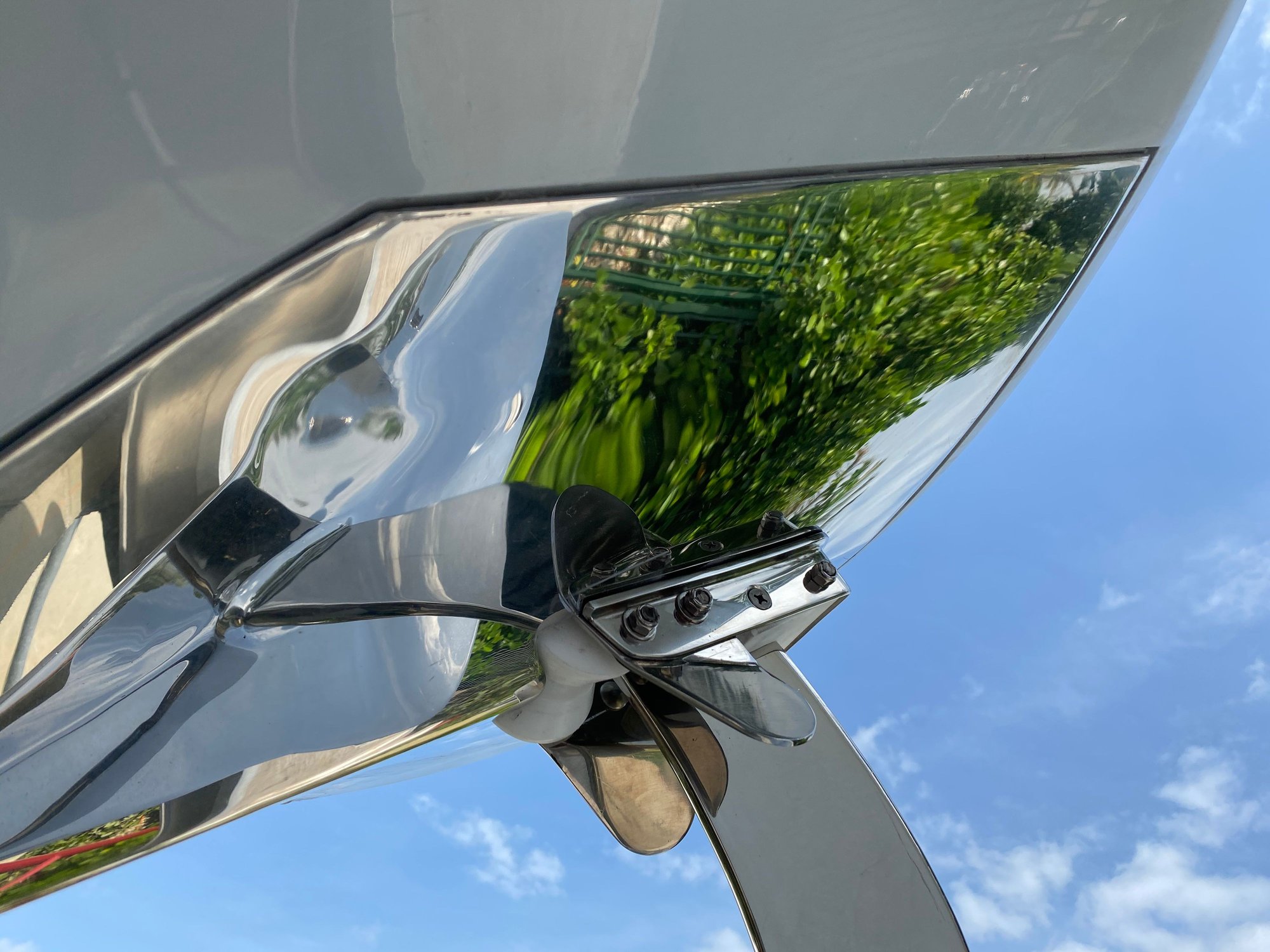

Stainless steel trim around some areas. It’s an old pic, it’s already welded and half of it high polished. spot welded in place , then hit with grinder and polished. Had to add more weld. Like everything else, it’s taken longer than expected
https://cimg3.ibsrv.net/gimg/www.off...d02a20442.jpeg
https://cimg4.ibsrv.net/gimg/www.off...2968bf810.jpeg
https://cimg5.ibsrv.net/gimg/www.off...55b10367f.jpeg

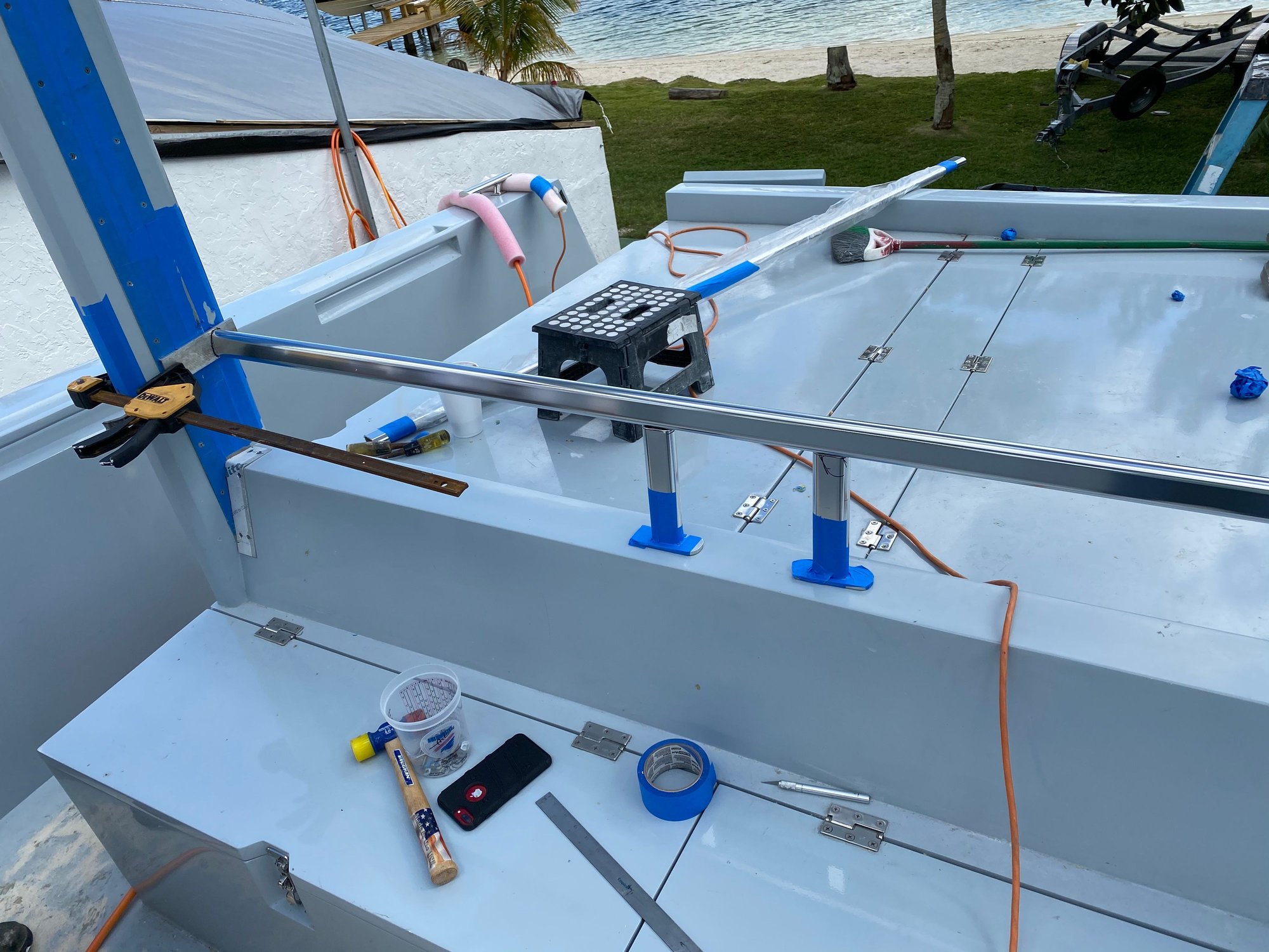

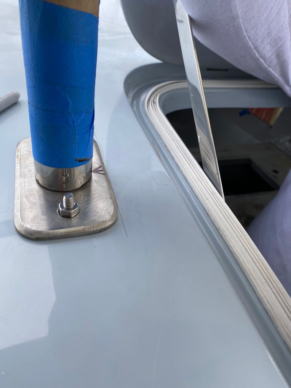

Added a post next to the helm, this was during fitting. It’s already welded and polished as well. There’s another post in the cabin directly underneath that this one bolts on to
https://cimg6.ibsrv.net/gimg/www.off...12774b6f3.jpeg

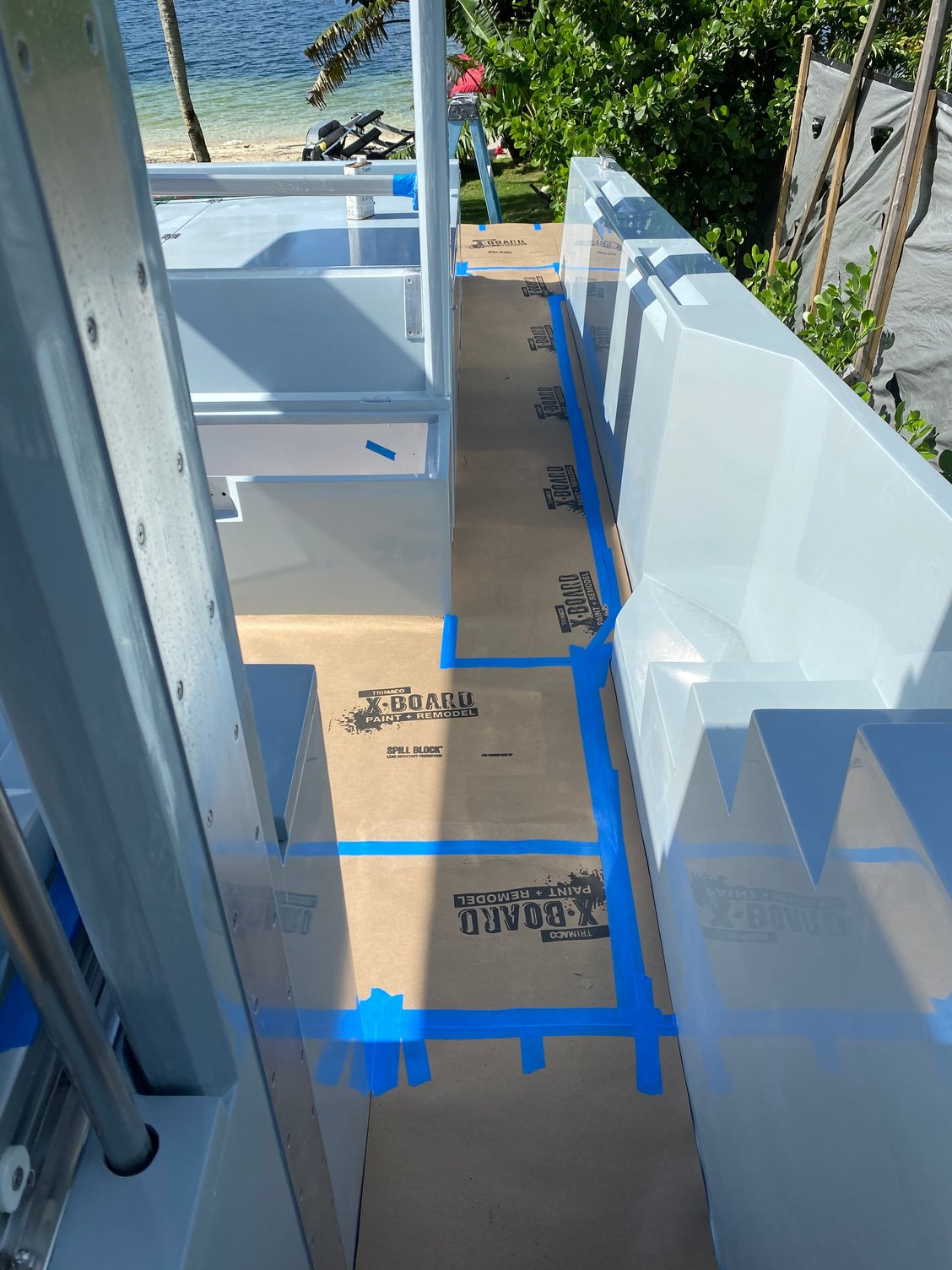

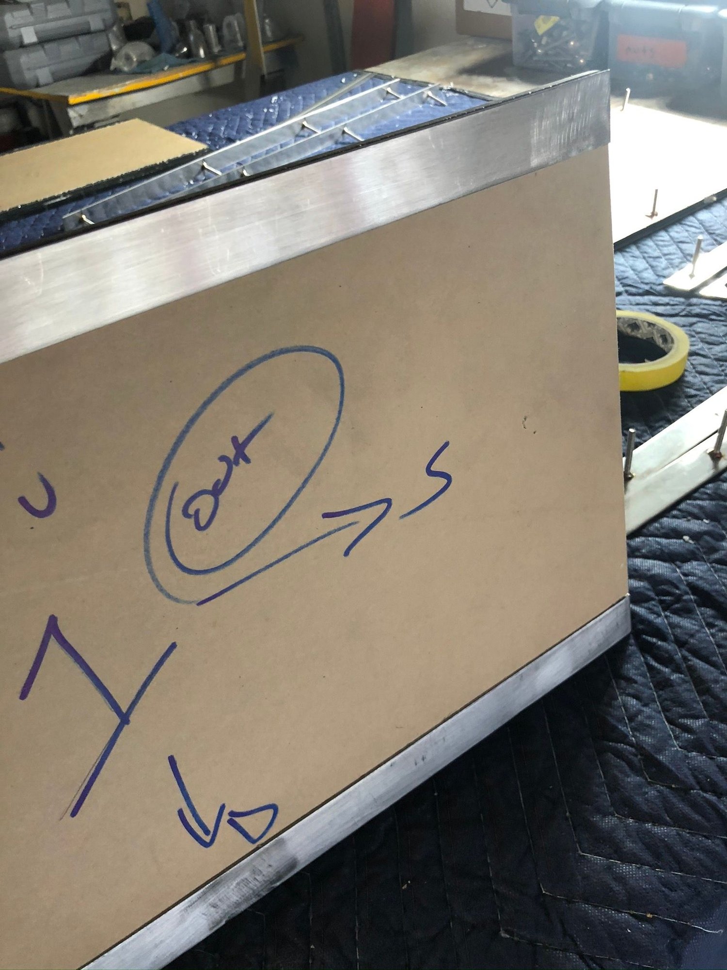

Pattern done for the synthetic teak deck
https://cimg8.ibsrv.net/gimg/www.off...1a21e1678.jpeg

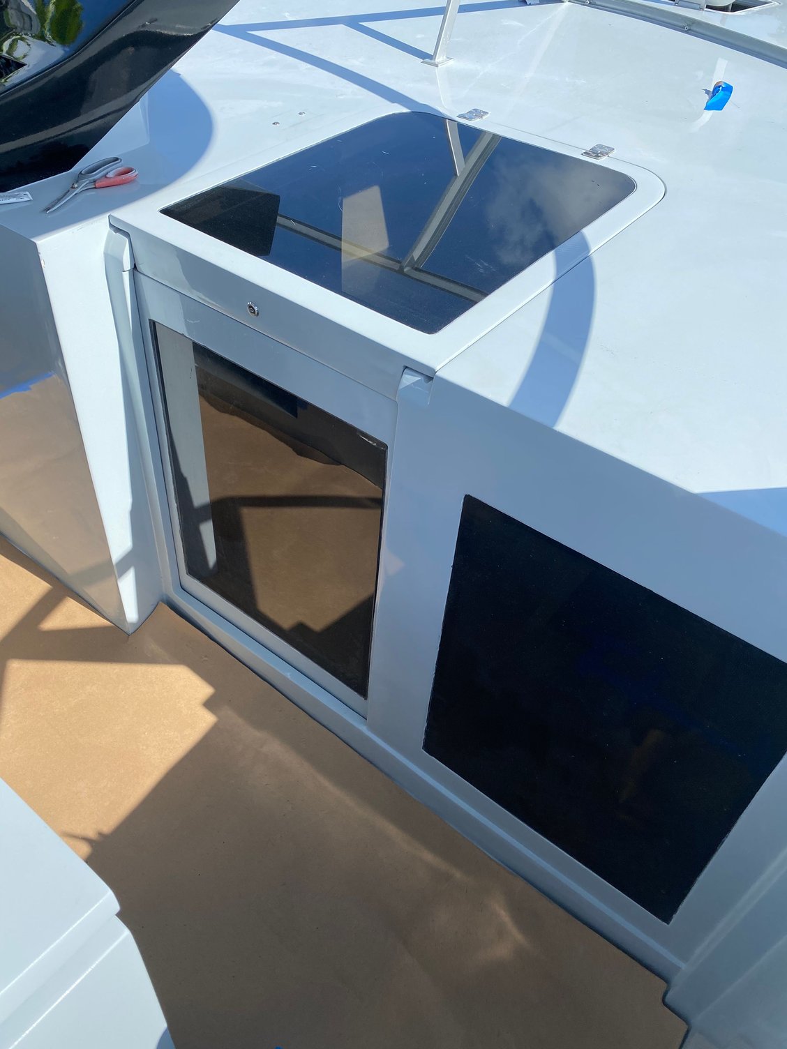

Plexi in most areas, some will have to get redone since it didn’t pass the hose water test :(
https://cimg0.ibsrv.net/gimg/www.off...7ac683368.jpeg

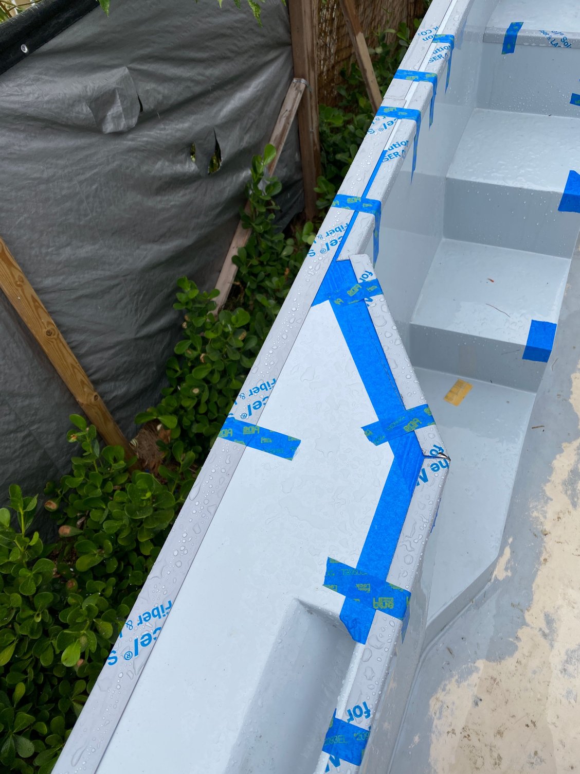

Aluminium bar backrest done
https://cimg3.ibsrv.net/gimg/www.off...0ea2ee7a0.jpeg

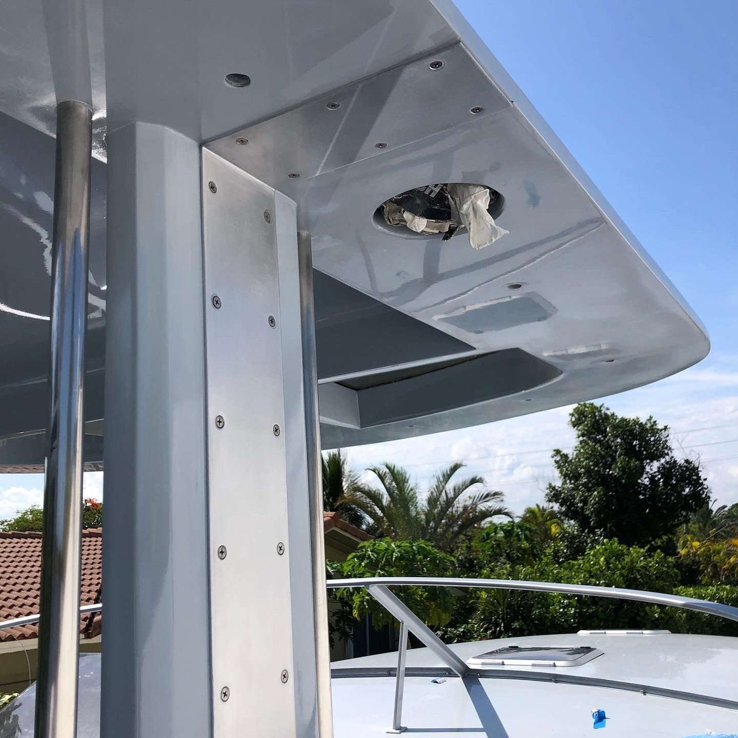

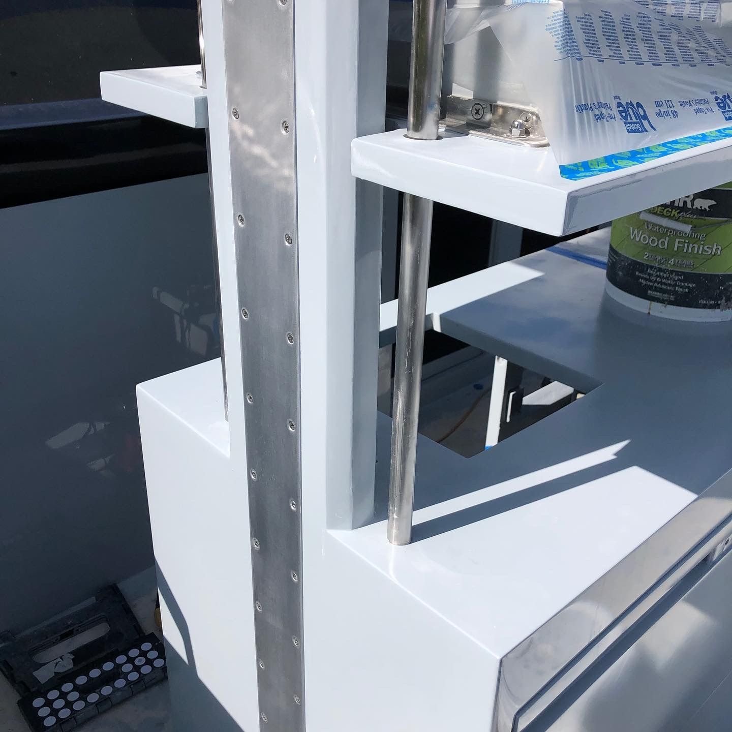

Aluminum plates to cover the reinforcement we did on the columns
https://cimg4.ibsrv.net/gimg/www.off...34b7d47a5.jpeg
Counter sunk screws and 3 layers of clear-coat with airbrush
https://cimg5.ibsrv.net/gimg/www.off...e52b50c5a.jpeg

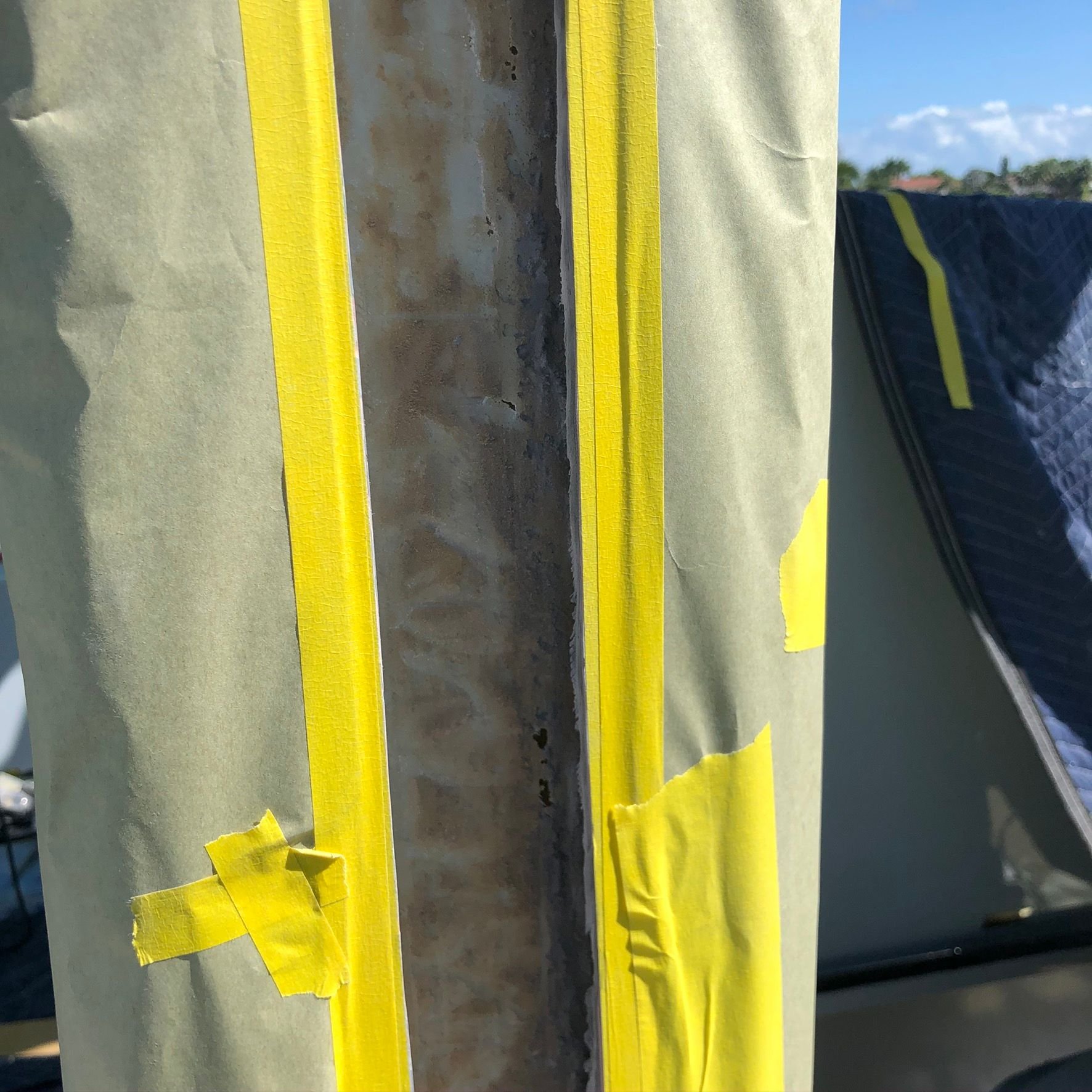

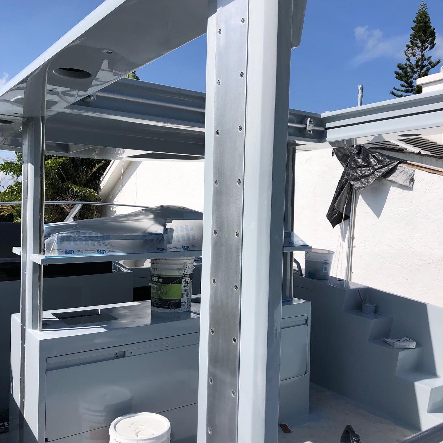

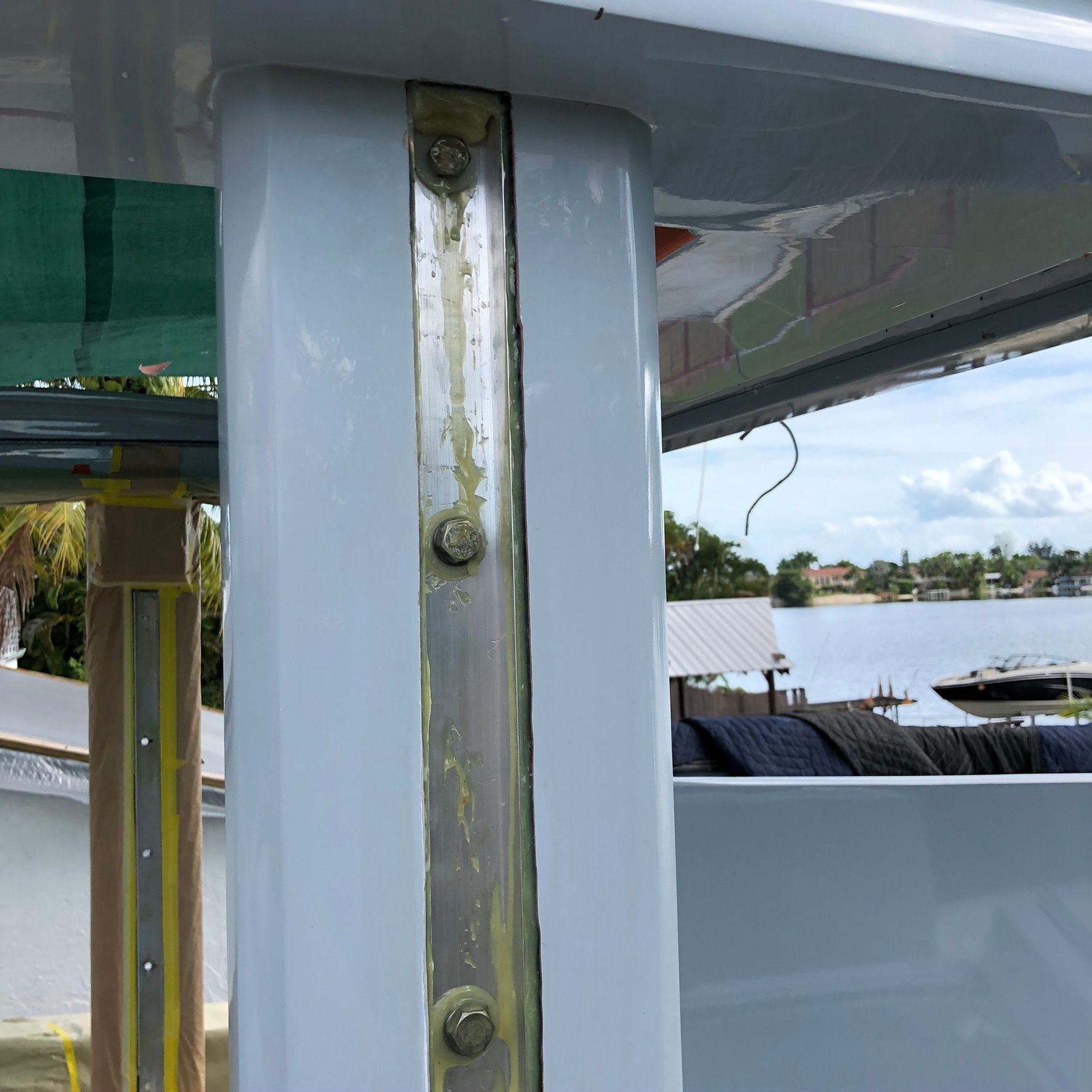

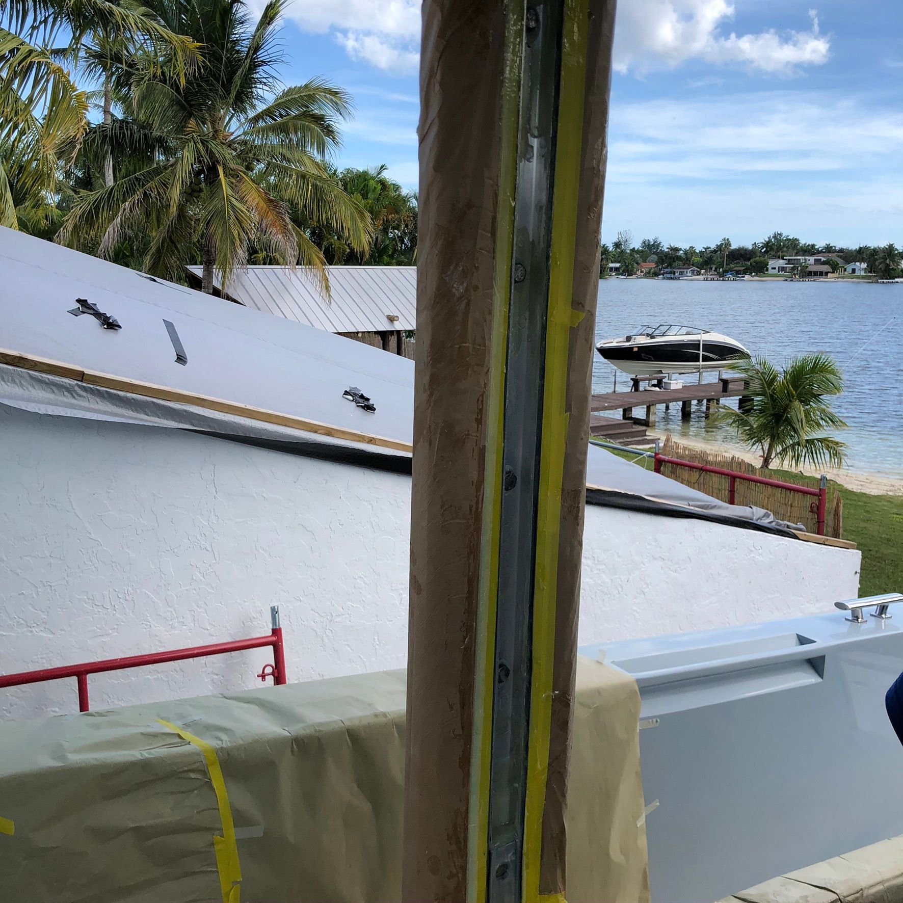

So one day I woke up worried that the carbon fiber columns were not going to be strong enough to support the top, so for better or for worse I added structural channels on either side of each column, as well as reinforcements were the columns meet the furniture.
https://cimg2.ibsrv.net/gimg/www.off...2afa1c967.jpeg
https://cimg6.ibsrv.net/gimg/www.off...abfa39cce.jpeg
https://cimg7.ibsrv.net/gimg/www.off...3198f0cfc.jpeg
https://cimg8.ibsrv.net/gimg/www.off...2c816177a.jpeg
https://cimg9.ibsrv.net/gimg/www.off...4842e4901.jpeg
https://cimg2.ibsrv.net/gimg/www.off...84db0074b.jpeg

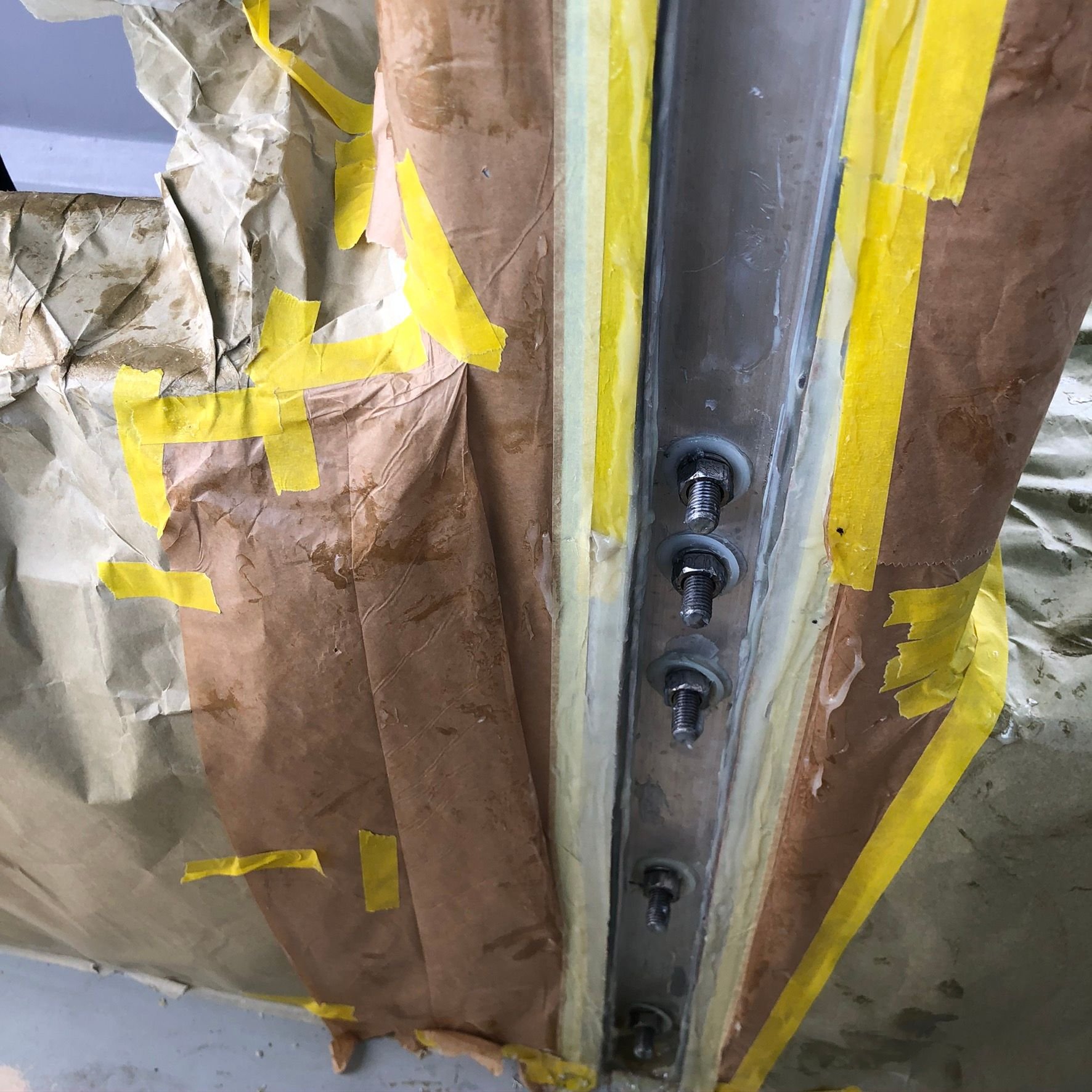

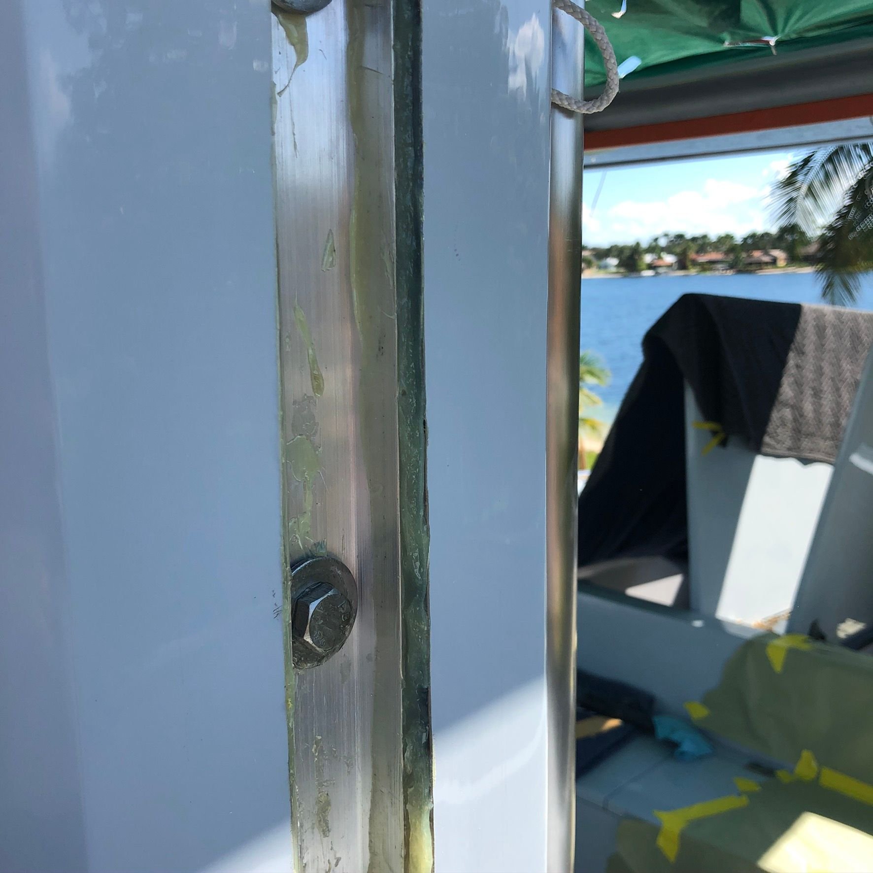

Plexus window with stainless plates. These have welded bolts on the back that get washer and nuts Inside the cabin
https://cimg3.ibsrv.net/gimg/www.off...ed9588f26.jpeg

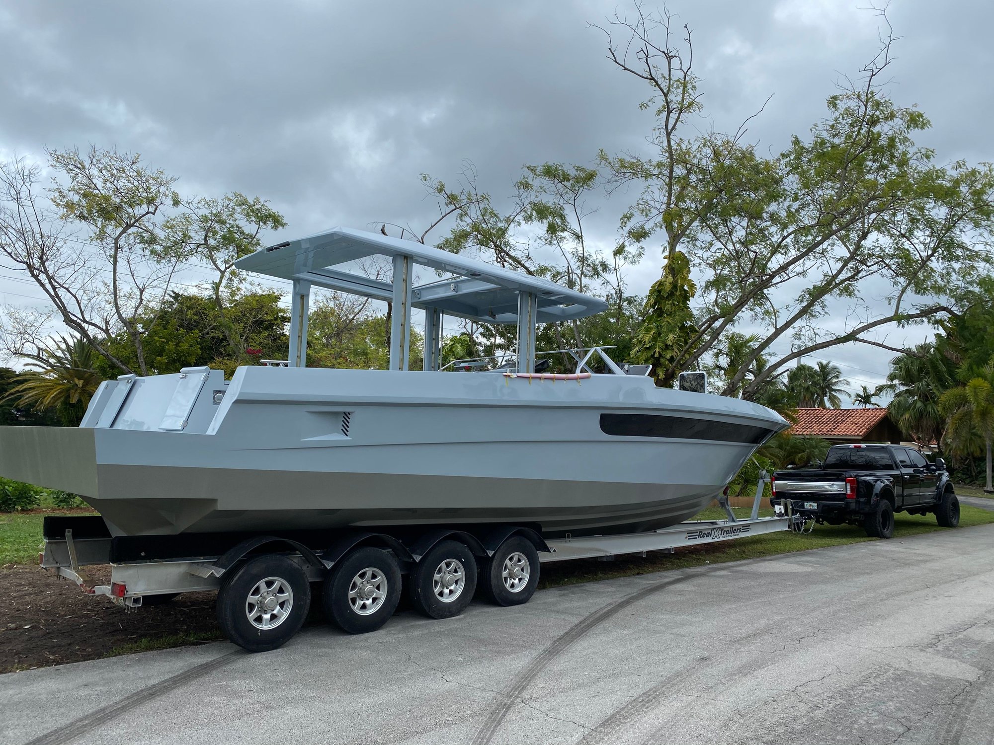

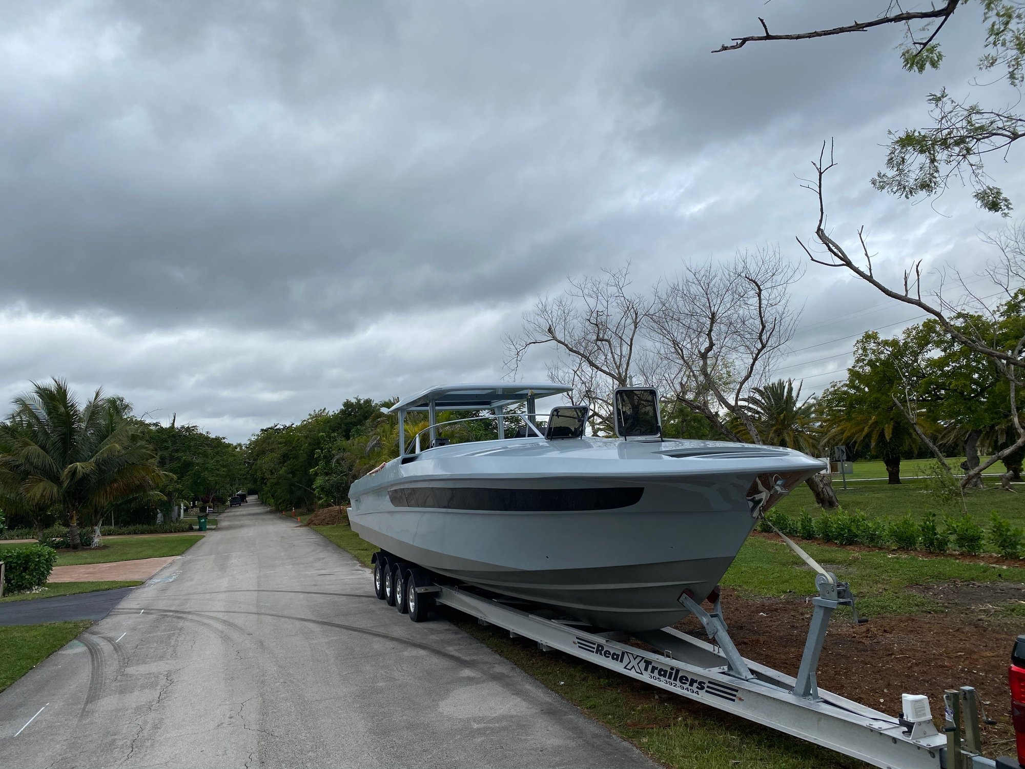

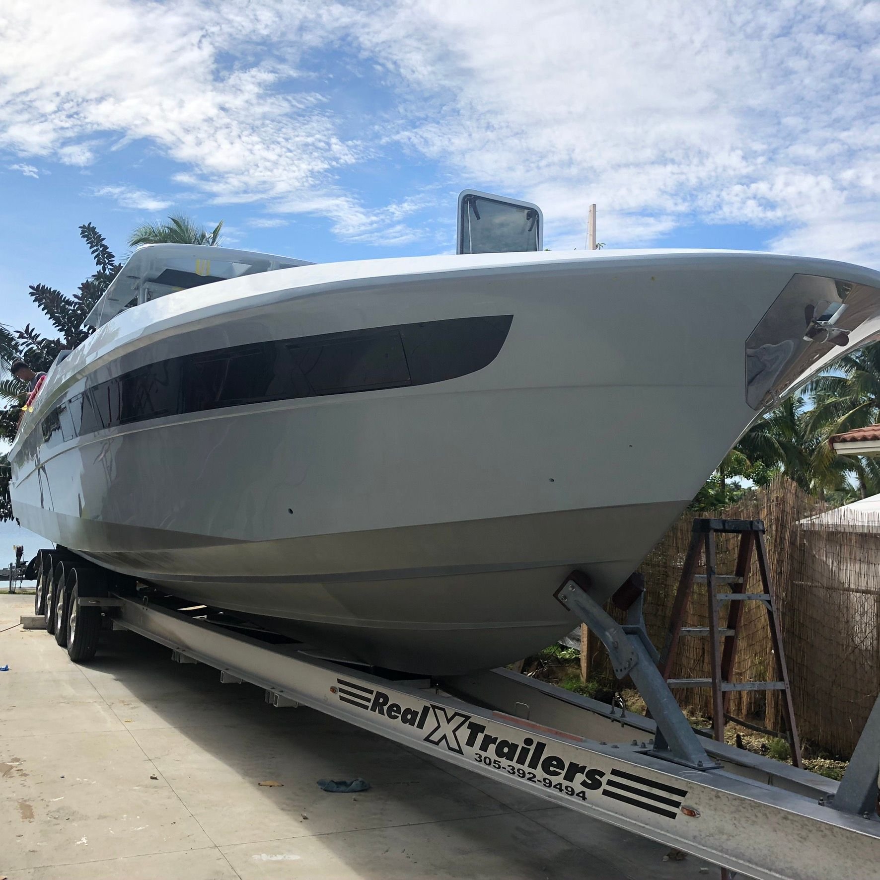

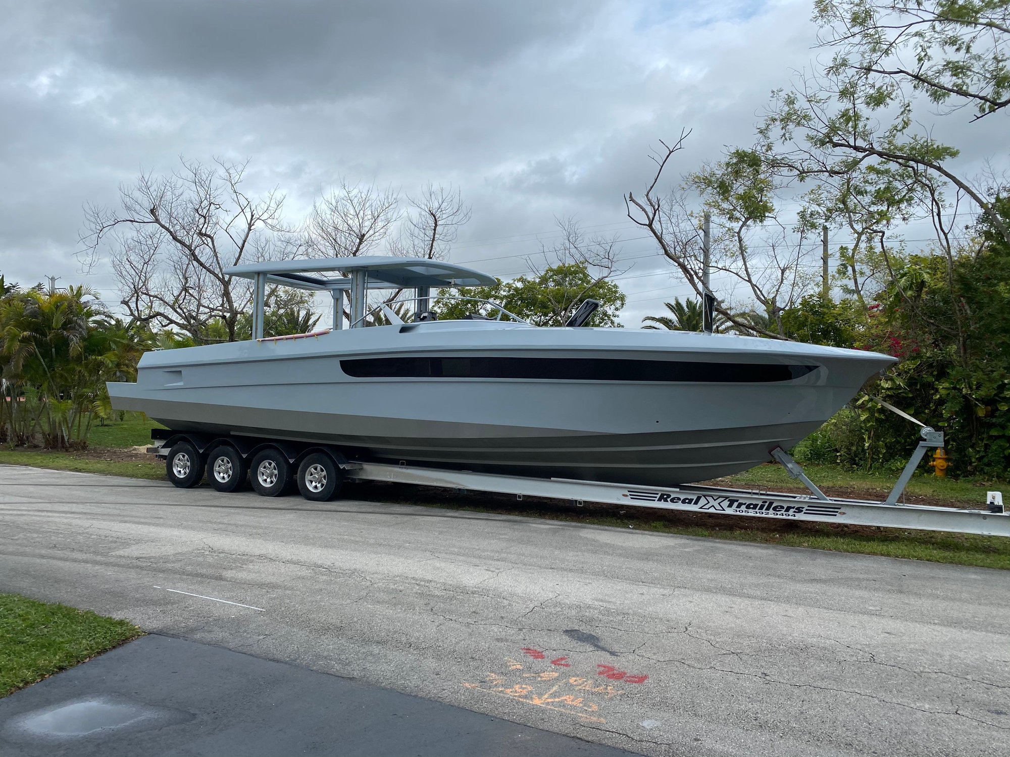

First time I can take a photo from a distance . .
https://cimg0.ibsrv.net/gimg/www.off...ac35cdfde.jpeg
https://cimg3.ibsrv.net/gimg/www.off...5dd8c4d98.jpeg
https://cimg4.ibsrv.net/gimg/www.off...613cc2a76.jpeg
https://cimg5.ibsrv.net/gimg/www.off...a74535d1d.jpeg
