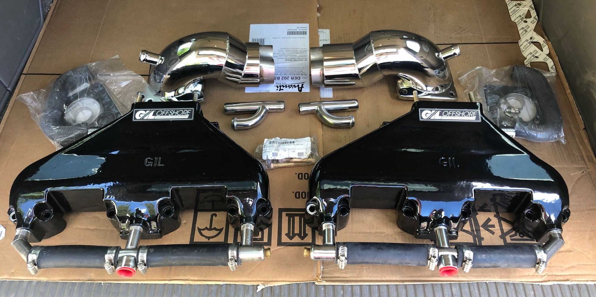

DjMikeyC 07-01-2019 02:33 PM
Picked them up the other day, they were NOS in the box. Looks to be a complete kit. Also included were the gaskets and all the 4" hose I will need. And a bracket I believe is a shift cable bracket (#0906112). Also came with the 2 stainless steel "Y" fittings used to plumb a 4-port thermostat housing down to 2 hoses for water outlet to the exhaust manifold connections. Not sure if I will use these or change the thermostat housing completely. Changing from the old mercruiser log manifolds to these I will need to source a water separator bracket and an alternator bracket.

Ok, getting ready to start this project and swap the manifolds... Looking for some advice from those that have done the swap from logs to center type or performance type manifolds...
Should I keep the old 4-port thermostat housing and use the y connectors so it outputs to 2 hoses or should I just buy a new thermostat housing? If purchasing new what thermostat housing do you guys recommend?
I need to relocate the starter relay, does anyone make a bracket to do this so its not attached to the exhaust manifold?
I need to get a bracket for the alternator as the old one attached to the front of the exhaust manifold. Anyone have any ideas whats out there?
Also need to get a bracket for the fuel filter / water separator as the old one attached to the front of the exhaust manifold. Anyone have any ideas whats out there for this?
