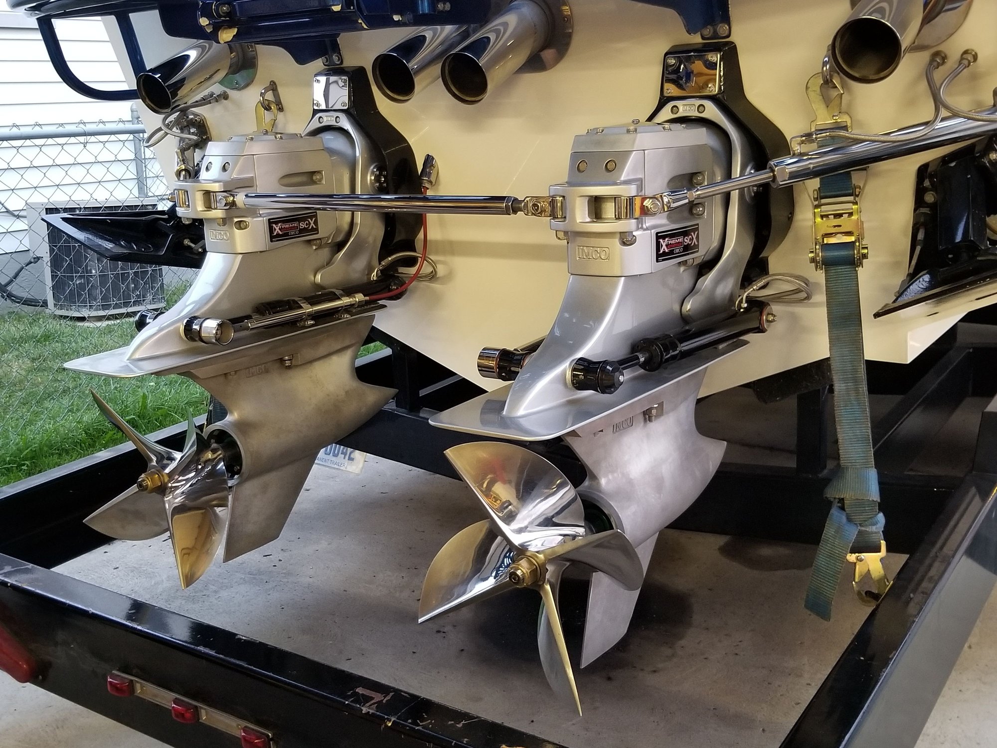

272lsformula 08-29-2019 09:26 AM
https://cimg4.ibsrv.net/gimg/www.off...00117acc35.jpg
I have been running 875hp in a heavy old straight bottom 38 scarab for 2 years with no problems so far.

272lsformula 08-29-2019 03:25 PM
https://cimg0.ibsrv.net/gimg/www.off...866ec999de.jpg
540ci with 8-71s 4% underdriven. So far the best mph with the scx's is 87mph @ 5200 rpm. I am raising the drive up another 1/2in. and testing it out this weekend. The 17 x 28 4 blade cleavers worked the best out of all the props i have tried. 30 and 32 bravo1 4 blades, 15.625 30 pitch maximus, 17x26 4 blade cleaver and a 17.5x 30 4 blade cleaver. Hopefully raising the prop will get me alittle rpm. My goal is to get it to run 90mph with 3/4 to full tank of and couple of people in the boat.

272lsformula 08-30-2019 11:37 AM
Originally Posted by saathoff05 (Post 4704704)
How was the conversion process? Any issues or were they really bolt on a go? with the hat change..
I had no issues, I changed to the imco HD gimble ring also. Everything bolted up as it should have with no problems.
