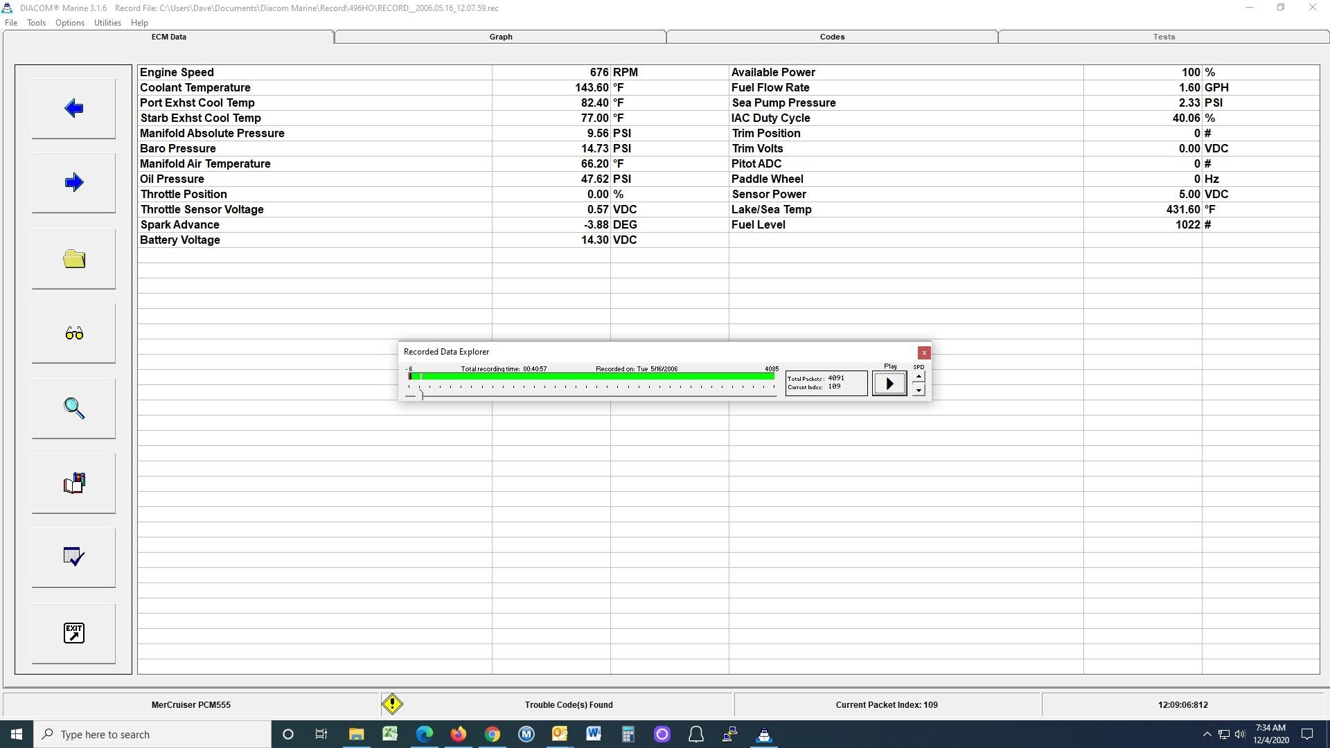

Hi I found the one that I bought on Ebay from a boat/Merc Dealer in Las Vegas who put it on sale for black Friday. I think that he's out of stock as he only had a few of them but you can still get a nice deal on these on Amazon for a limited time only for $173 vs the $225 normal retail price. BTW this will work on many different Merc engines including outboards, it looks like the features that are available to you depend on the engine's computer model that's why I'm curious to see if the PCM 555 that are on the 496 Mag HO engines will show the real time fuel pressure on this app while the engine is running at various throttle positions.

Here's what Diacom software pulled from the 496HO (2004) I owned. I assume this is everything Smartcraft pulled. No fuel pressure, but it showed fuel flow in GPH. I have Verados now and it does show fuel PSI.
