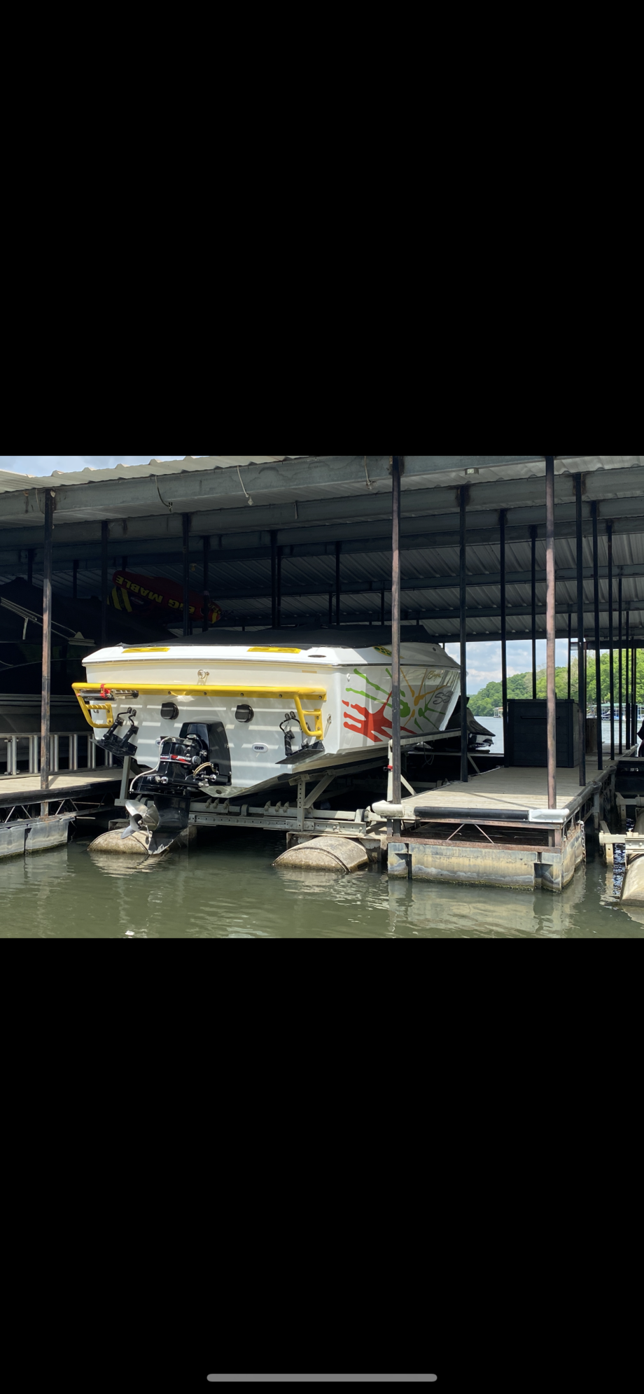

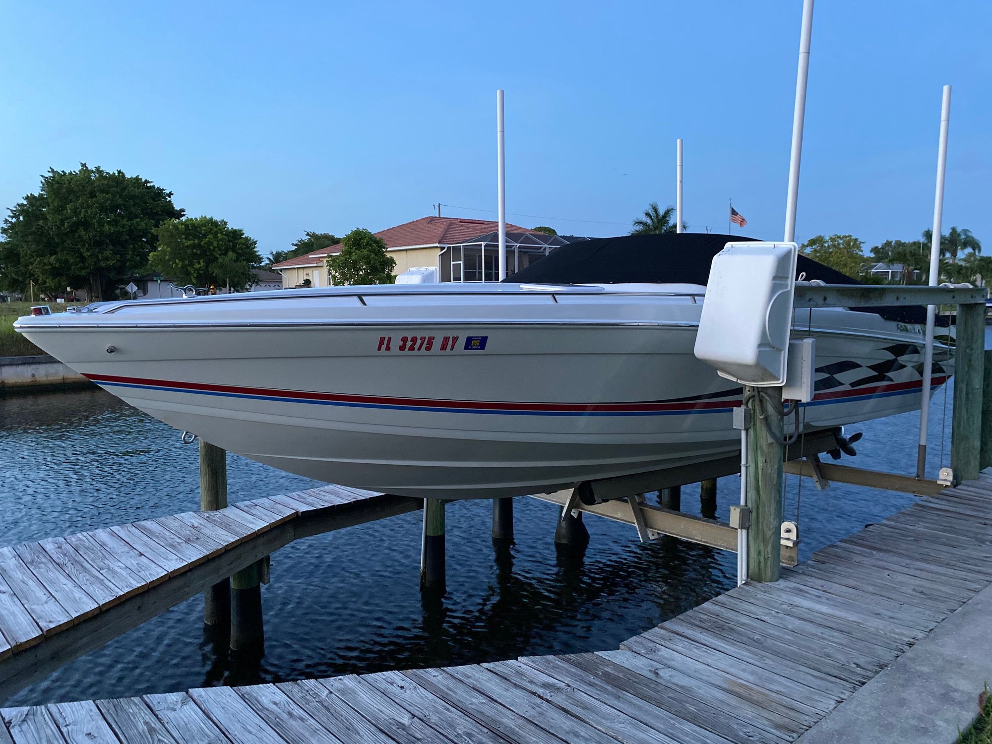

Boat Lift
Originally Posted by F14A water jet (Post 4790201)
I am hoping 24 degree deadrise boat owners may chime in (not chine in). I have a Formula 311 and a new boat lift. When I get the two bunks spaced wide enough apart to comfortably clear the chines/lifting strakes (red position), the keel touches (or almost touches) the cross beam. When I move the bunks closer (but still outside the lifting strakes), there is a possibility of catching the strakes when the wind/current interferes with my alignment. I am thinking of moving my bunks inside the chines (blue)...any first hand experience (positive and negative) with the blue location?
THANKS!
https://cimg9.ibsrv.net/gimg/www.off...fc0d82d0a1.jpg
This is something I just went through buying a new Poly Lift for my Baja with a 24 degree dead rise.
I would say that I prefer it to be outside the strake (red position) and that’s what I went with my Poly Lift. But honestly, being in the blue position (narrower) would work fine as well. It is just much harder to get seated on when it’s a holiday weekend or in the summer for that matter, since mine is at LOTO.
I would HANDS DOWN, recommend you go with a Poly lift and they will give you any option with bunk positioning you prefer. With everything said, wide is much easier to work with and less stress overall.
HOPE this helps!
