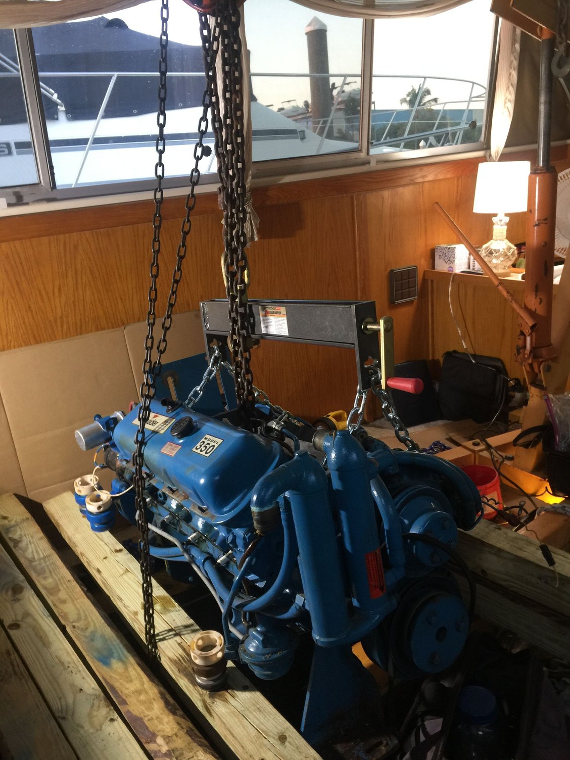

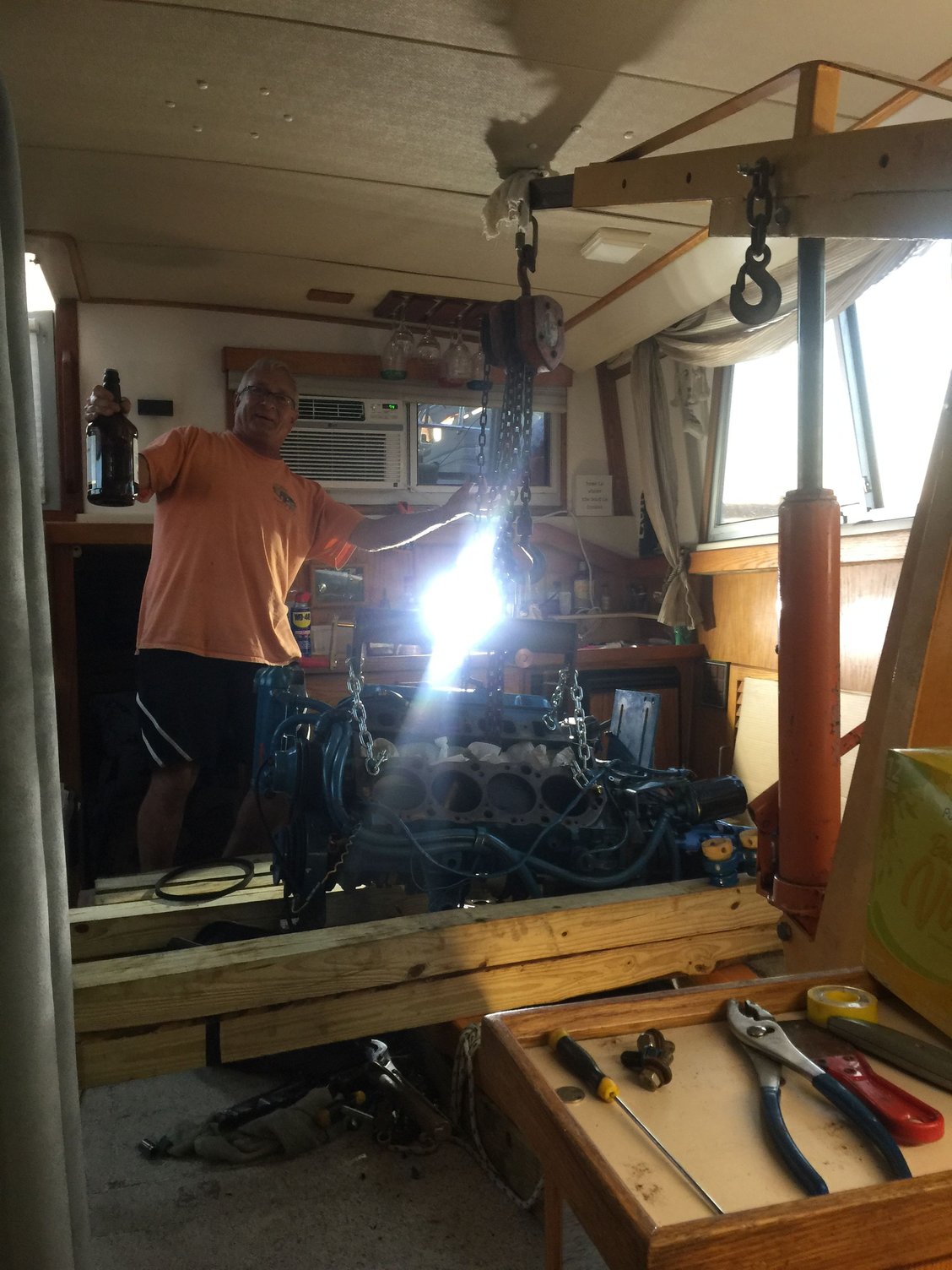

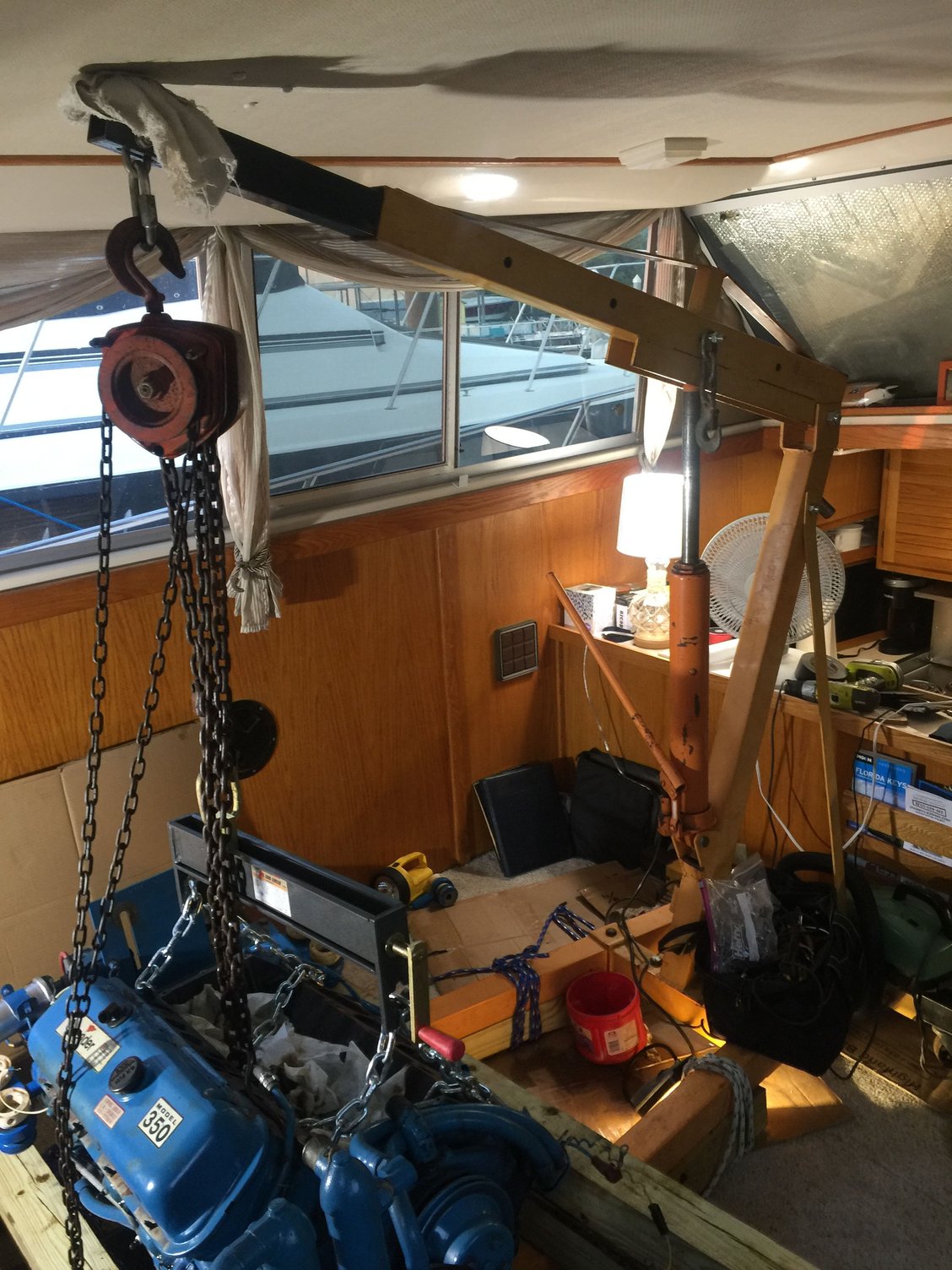

As you can see I only want to deal with this nightmare once. Still have to get it out of a 21 inch wide hatch/door.

Wait. You pulled a motor from an air conditioned engine room / compartment and your complaining ? :wink lol

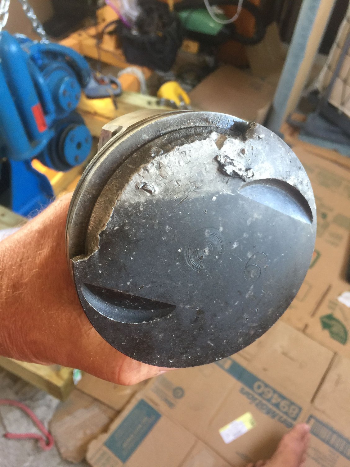

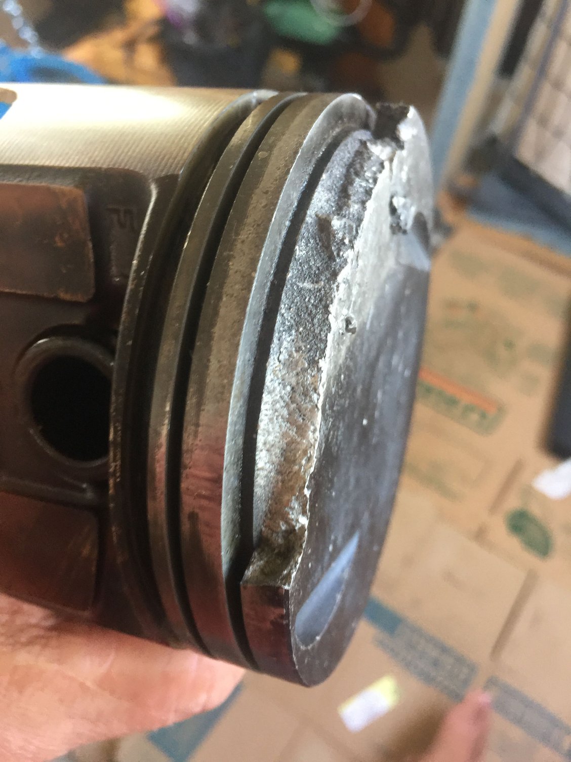

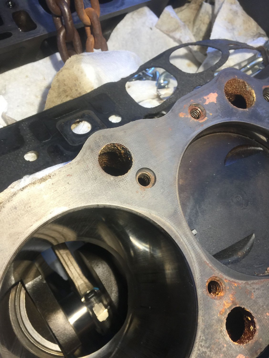

Tore the head off after hearing a clacking and this cylinder testing low for compression . Cylinder is like new so I found a almost like brand new exact Oem # piston and rod on eBay and was going to slap it in and run it .
He cooked the piston hotttrodding the 2000 hour motor from some bad gas and too much load while out for a spin with a boatload of girls onboard.
All other cylinders tested 135-150. Boat is a designated low speed trawler now I told him.
Put my borascope down the other cylinder bank for chits and giggles and found a severely scored cylinder that showed good compression .
Its his winter liveaboard that doesn’t go anywhere but around the corner to the Gulf.

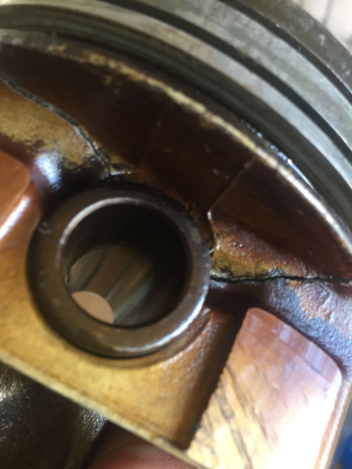

By the looks of the piston in the cylinder I thought was the bad one we shut it down just in time .
Im almost tempted to pull all the pistons and inspect them and try to dig up another OEM GM piston to slap in the scored hole after running a light hone through it.
I’m not worried about low compression in the one scored hole , just don’t want a piston that looks like the one in the pic unglueing .
Obly need 1600-2000rpms out of it from now on.
It would still be less less work than stripping the motor and getting it out of the salon .
Surprisingly the head that ate the piston is rather undamaged though I’ll pull the valves and post pics tomorrow.

Not even a ridge on any of the cylinders. Bearings on bad piston looked as new with no wear. Not bad for 2000 hours pushing a 25000 pound boat for the last 36 years including a 1500 mile almost wide open trip down the Mississippi from Lake Michigan to Fort Myers Beach 9 years ago.
