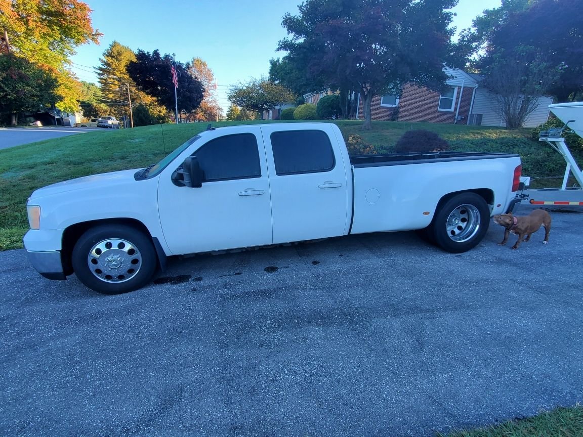

i have this one i could let go, i have my eye on a sportchassis
https://cimg4.ibsrv.net/gimg/www.off...d75e49ac7.jpeg

snapmorgan 11-22-2022 01:02 PM
https://cimg7.ibsrv.net/gimg/www.off...8774ea3a90.jpg
Why do you have a picture of my dog?
