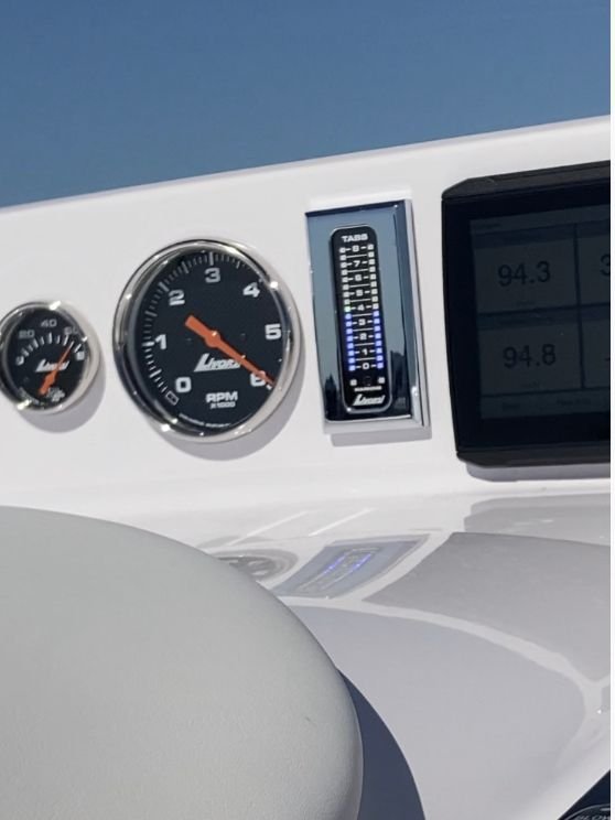

Hoodoo 2.0 05-24-2023 08:47 AM
Originally Posted by Brad Christy (Post 4868459)
Hoodoo,
Does he really want to, though....?
Thanks. Brad.
LOL I’ve never been accused of overthinking stuff but I don’t think 6k is Armageddon. This just tells me my 30’s were small and 32’s were probably close to were I wanted to be.

Brad Christy 05-24-2023 09:04 AM
https://cimg2.ibsrv.net/gimg/www.off...c212b50fe.jpeg
Hoodoo,
All good. OP stated, though, that the engines didn’t make power above 5K. That tells me he want to prop it for 5K. Right?
Thanks. Brad.
Hoodoo 2.0 05-24-2023 11:52 AM
Yes
Still helpful to know where your starting from.
