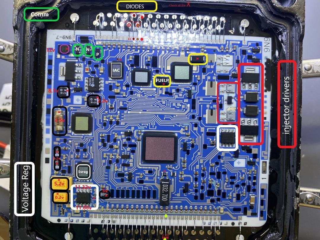

My hunch, at this point, given all the other rabbit holes you’ve been down that have not panned out, is that you may have a physical issue with your ECM. A quick verification for this is to borrow one known to be good from the same engine, including the “HO”, and see if the behavior goes away. Outside of that, the only means of checking it is to ship it off somewhere for a scan. A pic from BoatsUnlimited website:
