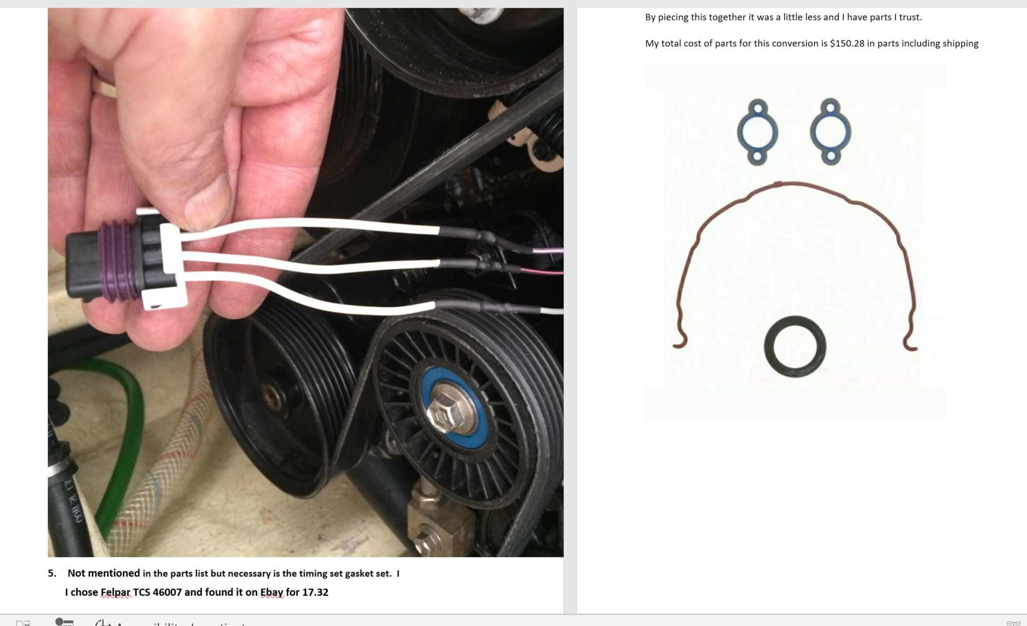

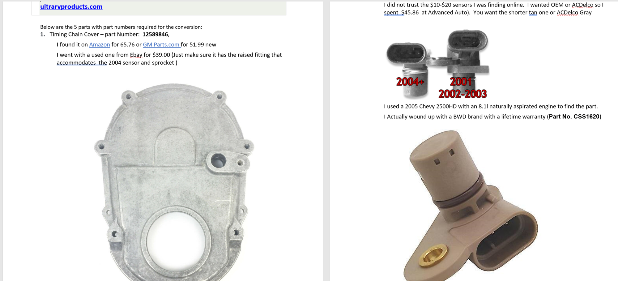

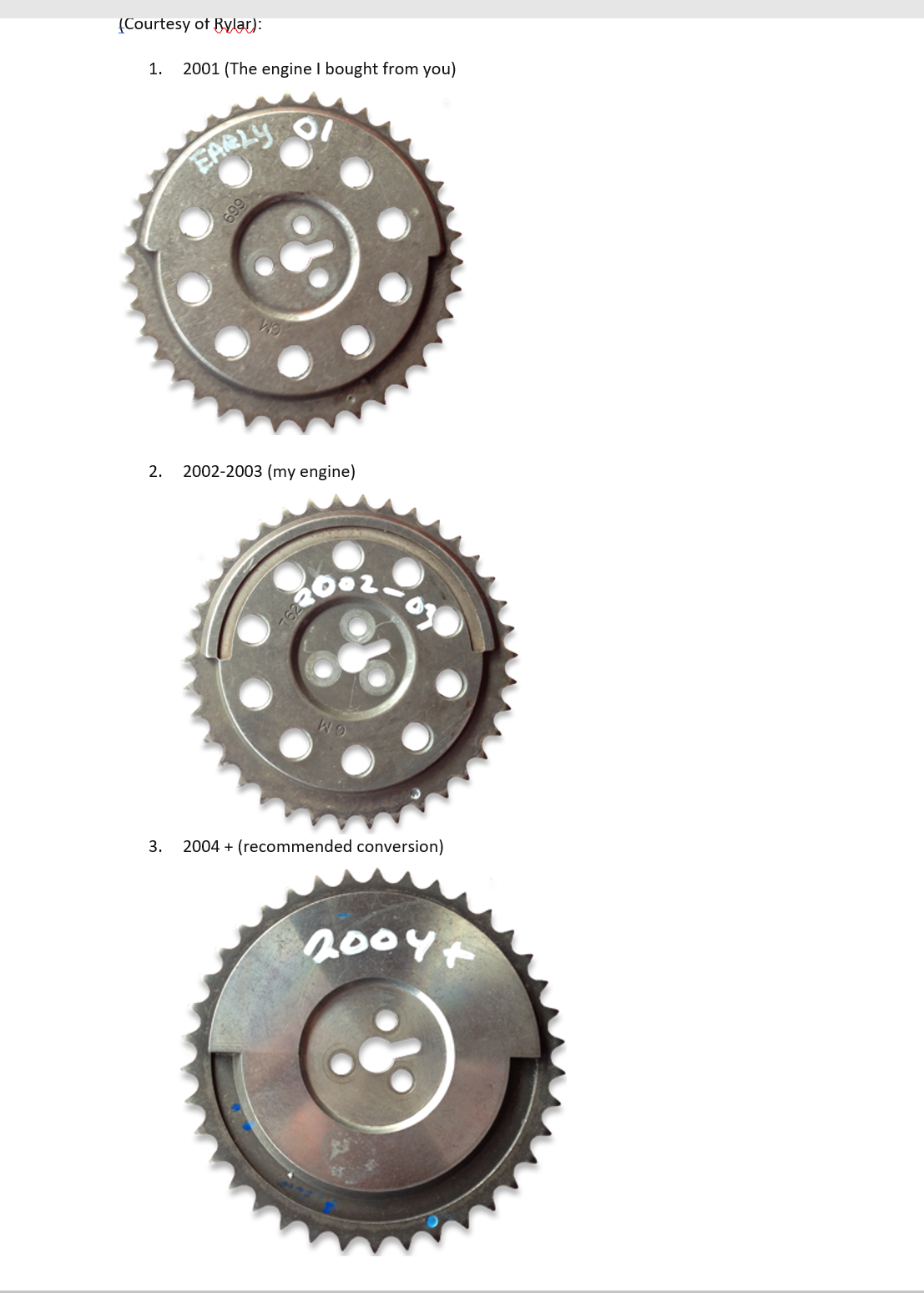

Dressed the short block from the old motor. Also changed out the Cam Position Sensor/timing cover/pig tail/sprocket (per BUPs post on here).
After all was said and done, the engine ran well when not in the boat. However, once in the boat, it starts and idles without issue. During the sea trial, it will not go over 1500 RPM. When pulling the codes it give says it cannot read the CAM Position sensor but it is an inactive fault. Also, when the engine is started the Tach reads, but when you give it gas, the tach drops to 0.
I have uploaded the documentation on what was replaced and included my write up when the cam position sensor was replaced.

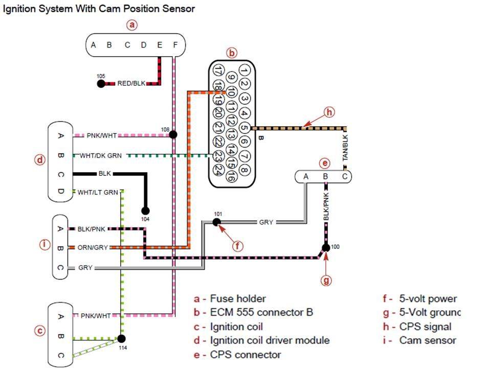

Do the wire colors on the cam sensor match up to pic?
