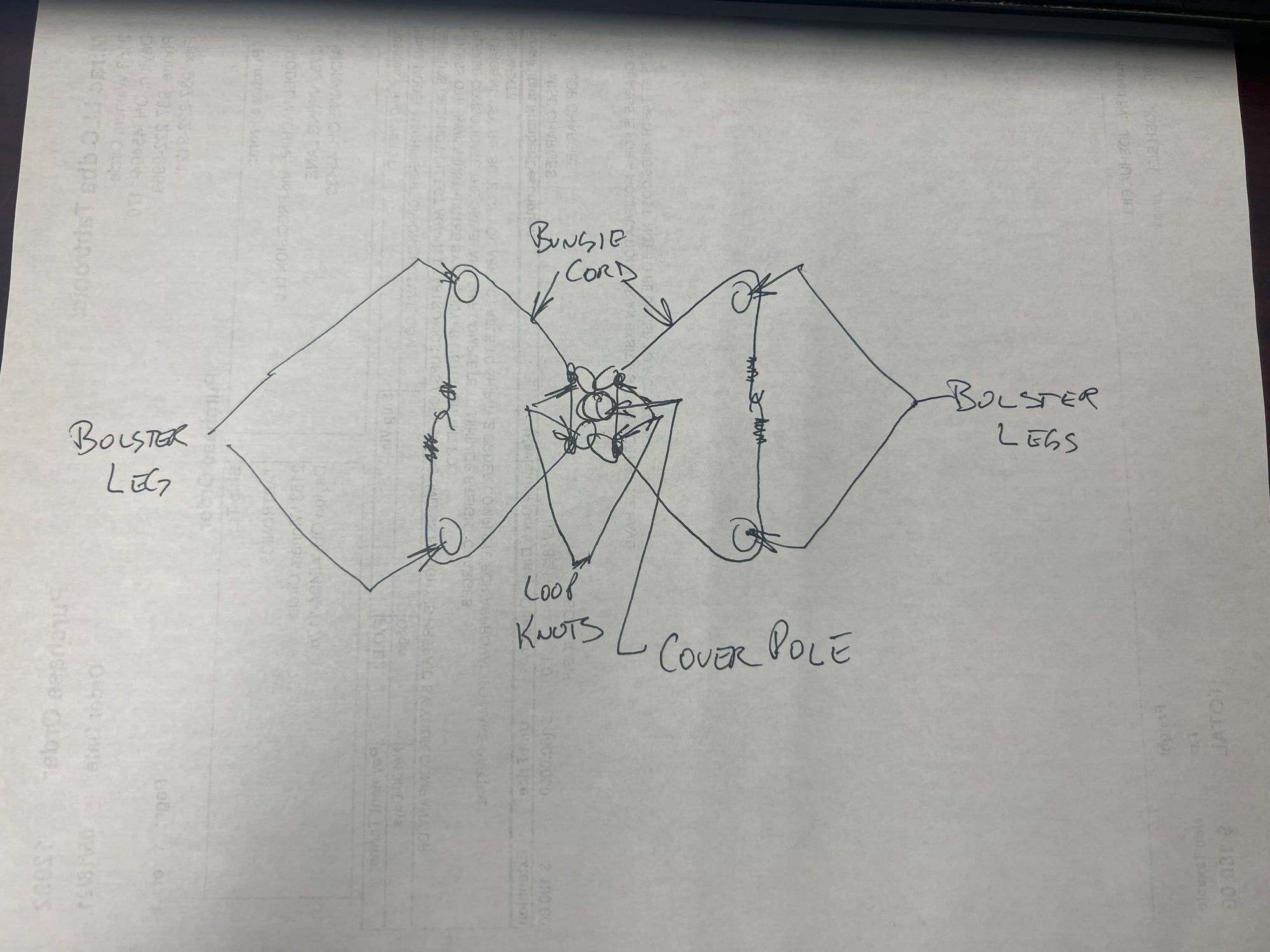

Ultraboy,
Assuming you have poles that are affixed to the cover in some manner, and it's the bottoms of the poles slipping out from under the cover that is the problem....
We have the same problem. I have been intending to make a "harness" out of bungie cords that will hook on the legs of our bolster seats and capture the bottom of the pole, similar to how an umbrella is nested under a patio table. Imagine an "X" of bungie cords with a circle in the middle. Don't know if this would work with your particular layout, though.
Thanks. Brad.
https://cimg0.ibsrv.net/gimg/www.off...40e2143aec.jpg
I'm not real proud of my own artwork here, but this is what I intend to do. A couple loop knots in the center of two bungie cords, interlocked with each other, forming a square nest, then stretch the cords around the bolster seat legs and hook them together. Lightweight, non-marring and temporary, but should secure the pole in place.
Thanks. Brad.

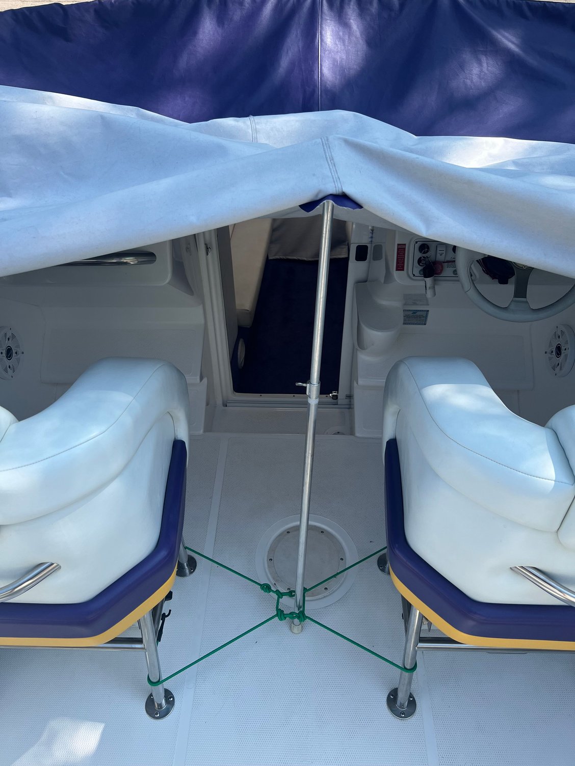

Guys,
I finally got around to working up the harness.
https://cimg8.ibsrv.net/gimg/www.off...d6bc5e7d1.jpeg
https://cimg9.ibsrv.net/gimg/www.off...f95333dca.jpeg
Gonna give it a road test tomorrow evening; taking to boat to Burnside for some work this coming week. I can’t see how the pole can get away, though.
It’s cheap, effective, lightweight, and shouldn’t cause any damage to anything.
Thanks. Brad.
