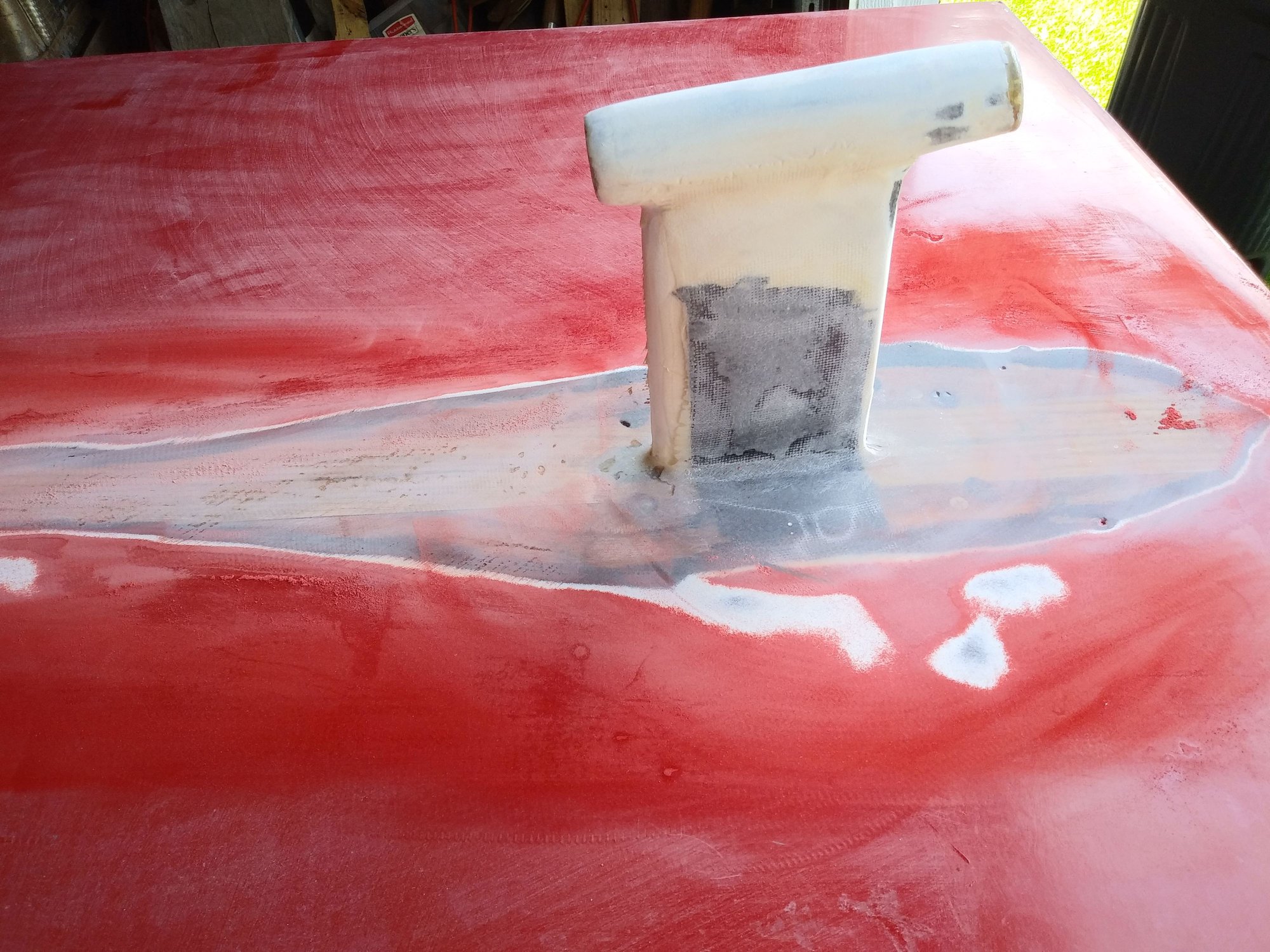

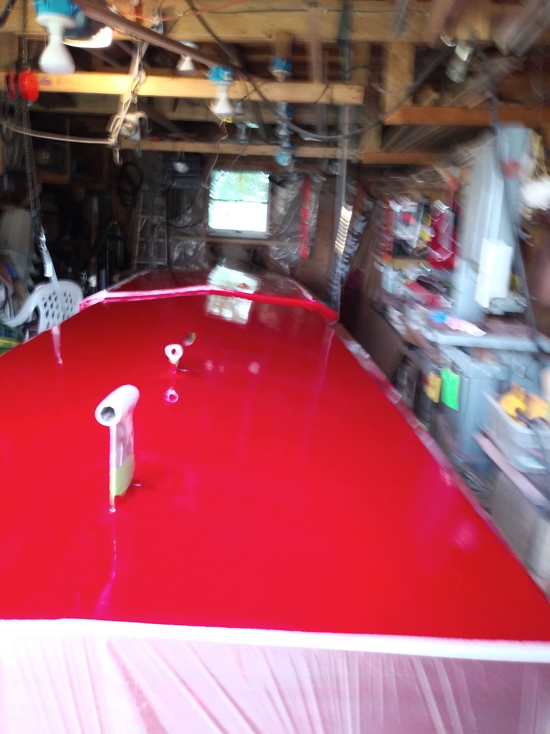

I have purchased two new 3/8 npt. bungs, which have been welded to the top of my two fuel tanks. Also two siphon tubes and anti-siphon valves. So now my two 12 gallon spun Aluminum fuel tanks are all set for top fuel draw. The next thing I need to do is purchase the fuel pump and filters plus fuel line and clamps. Over the last two weeks we finished gluing in and reinforcing the two struts with the boat upside down. After filling the cavity between the struts and keel with epoxy, I added four layers of carbon fiber and four layers of fiber glass with epoxy forming a 90 degree flange between the strut and the bottom of the keel and boat. This was all sanded and fared and a new coat of bottom paint applied. Boat is now back in the upright position and I striped the transom down to almost bare wood. Applied a thin coat of epoxy mixed with colloidal silica and the red stain powder to make it look uniform in color and appearance. This worked great. Very happy with how this turned out, so we decided to strip and re-sand the decks to do the same process.

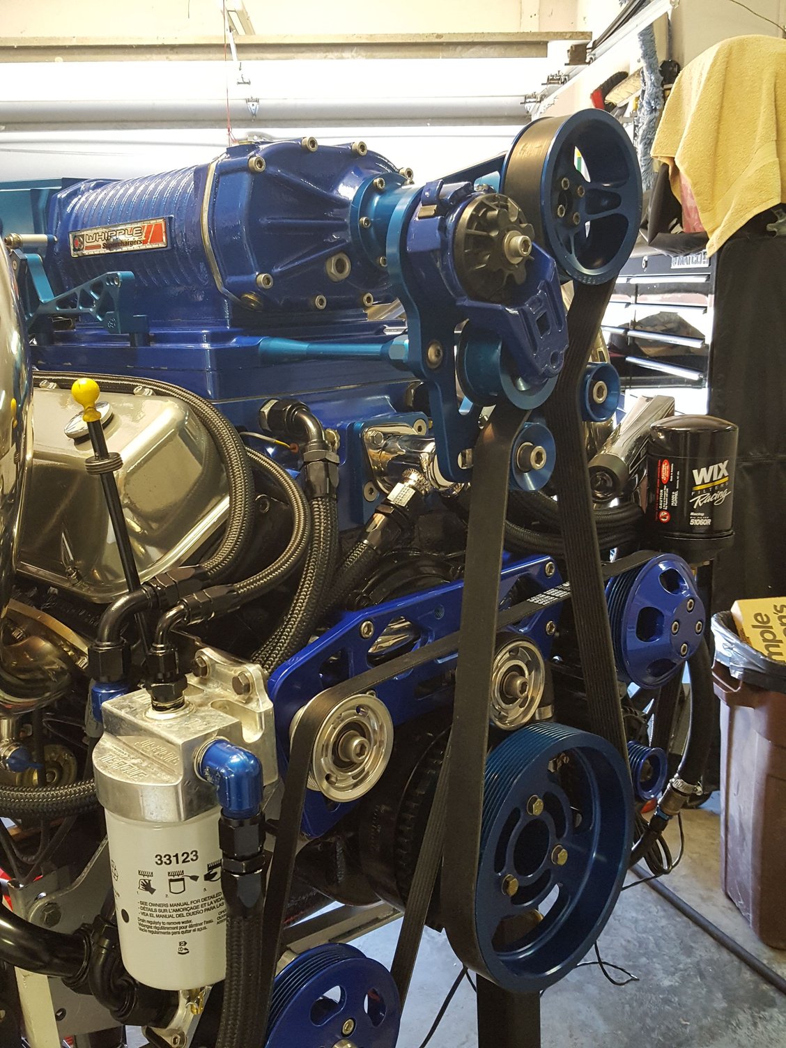

I like the nylon braided compression AN fittings...
