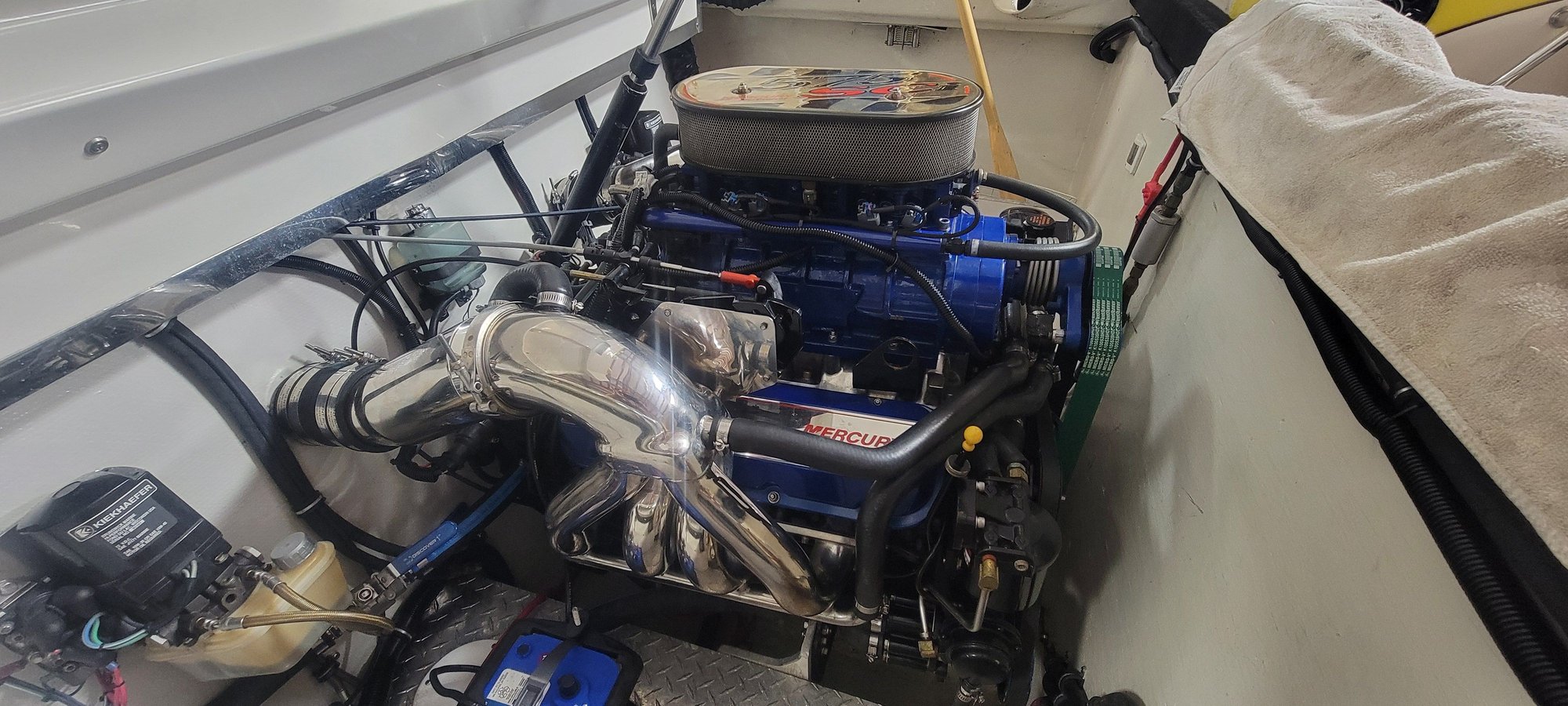

hpmaniac 06-09-2025 10:50 AM
Got the young performance injection conversion done on my sci 575, WOW what a difference in Fuel economy and smooth power. Boat has never ran so clean!!
Yesterday we were out all day and i did the same loop we always do, normally i would use 63-67 gallons and yesterday i used 46!! ran her up to 80 a few times.
Boat is a 2003 velocity 280. The fit and finish on this kit is amazing, and only 3 wires to connect haha. Great customer service.
