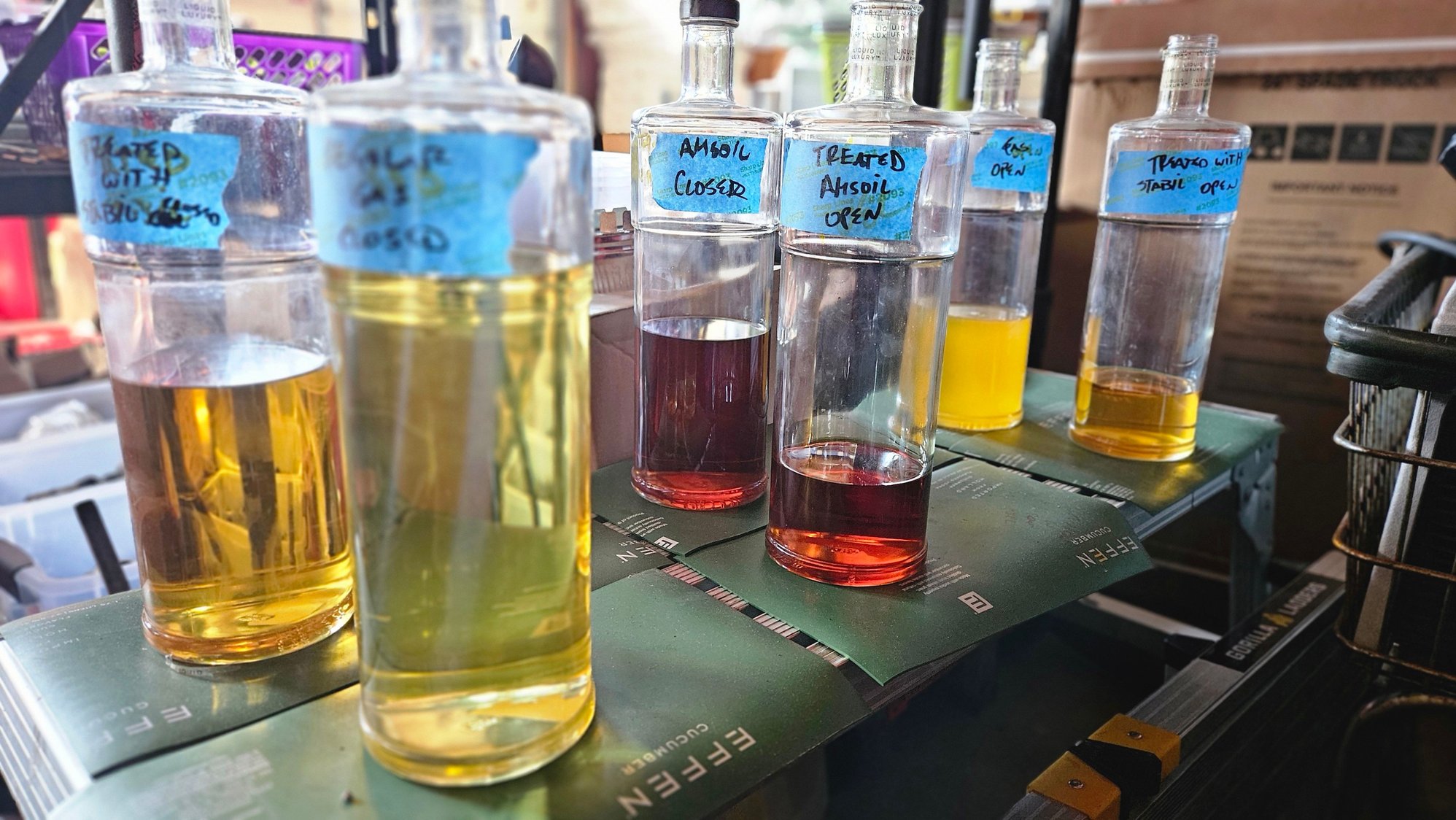

Keep in mind
I found that most of the Stabilizing products lower octane .. The Stabil brand was the worst .
https://cimg0.ibsrv.net/gimg/www.off...c2f9900237.jpg
