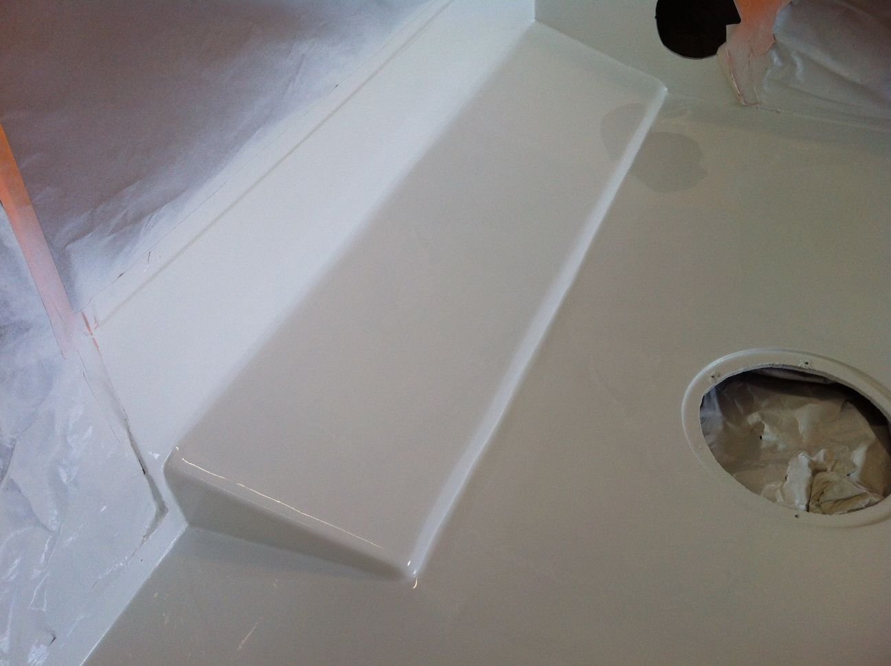

On my old 22' stinger it had a single foot rest in the middle under the driver only...i thought it was kinda stupid so i made it across for both the driver and passenger. (These are center steer boats)
Made the form from wood and glassed it solid since there's no holes or openings for moisture to get in it wouldn't matter. Never seen removable foot rests on a boat but that's not to say it doesn't exist.
