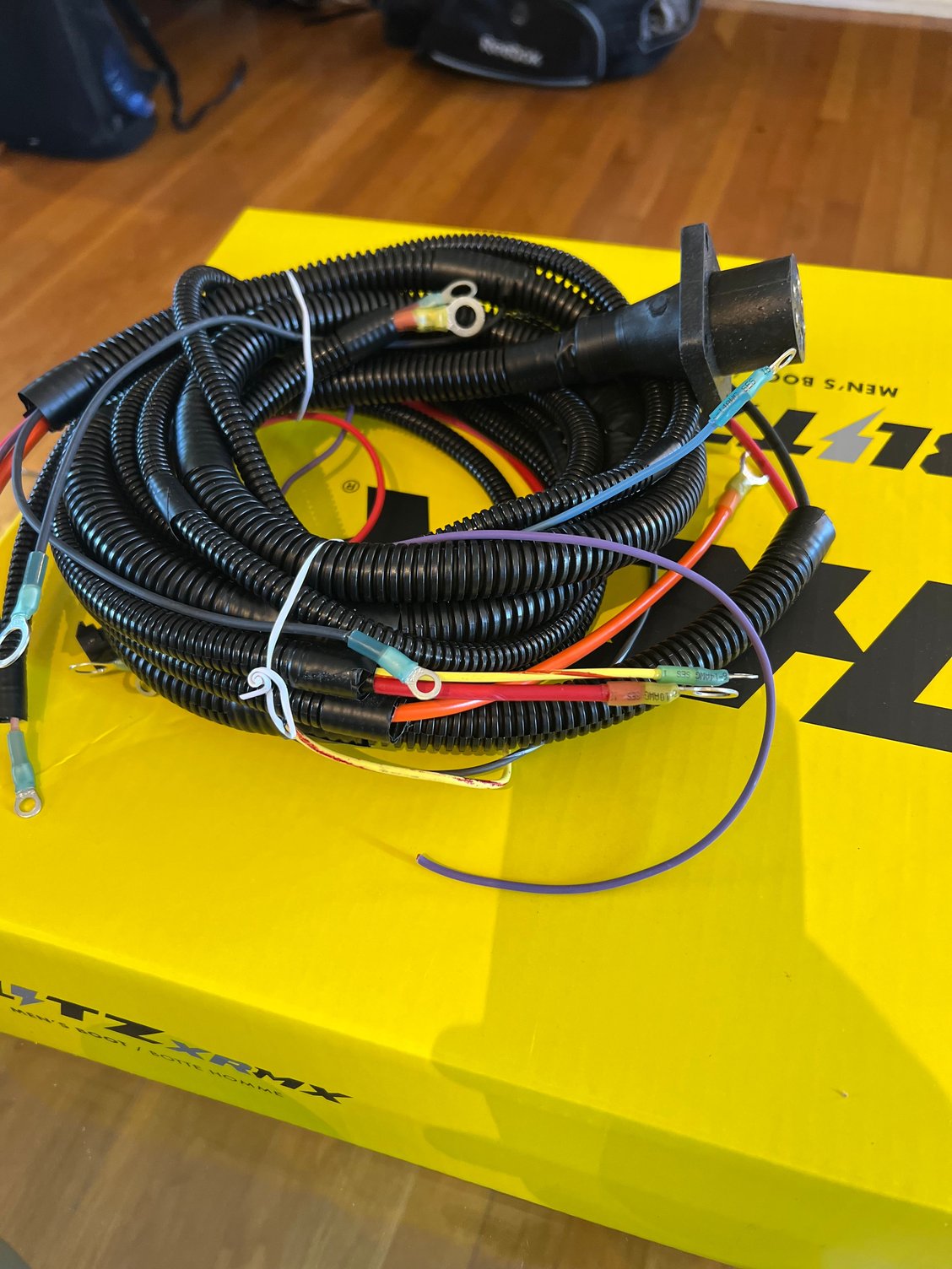

Appears to have been an Alternator Failure. I can’t post a video, but there are parts rumbling around inside the alternator and the terminal is burned to hell.
Two new Alternators on the way from Hardin. Also, big thanks to them as they had the Harness Below delivered two days later.
If I get out of this for $1,000 in parts, no one hurt and back on the water by July 4, I’ll consider myself lucky in an otherwise unlucky week (Boat Fire Saturday, Wednesday I had a new generator delivered and dropped off in the driveway and I ran over it with my RV 10 minutes later, and then Thursday night I tore my Planter Fascia in my foot and am walking around on crutches). Not my best week HAHA
