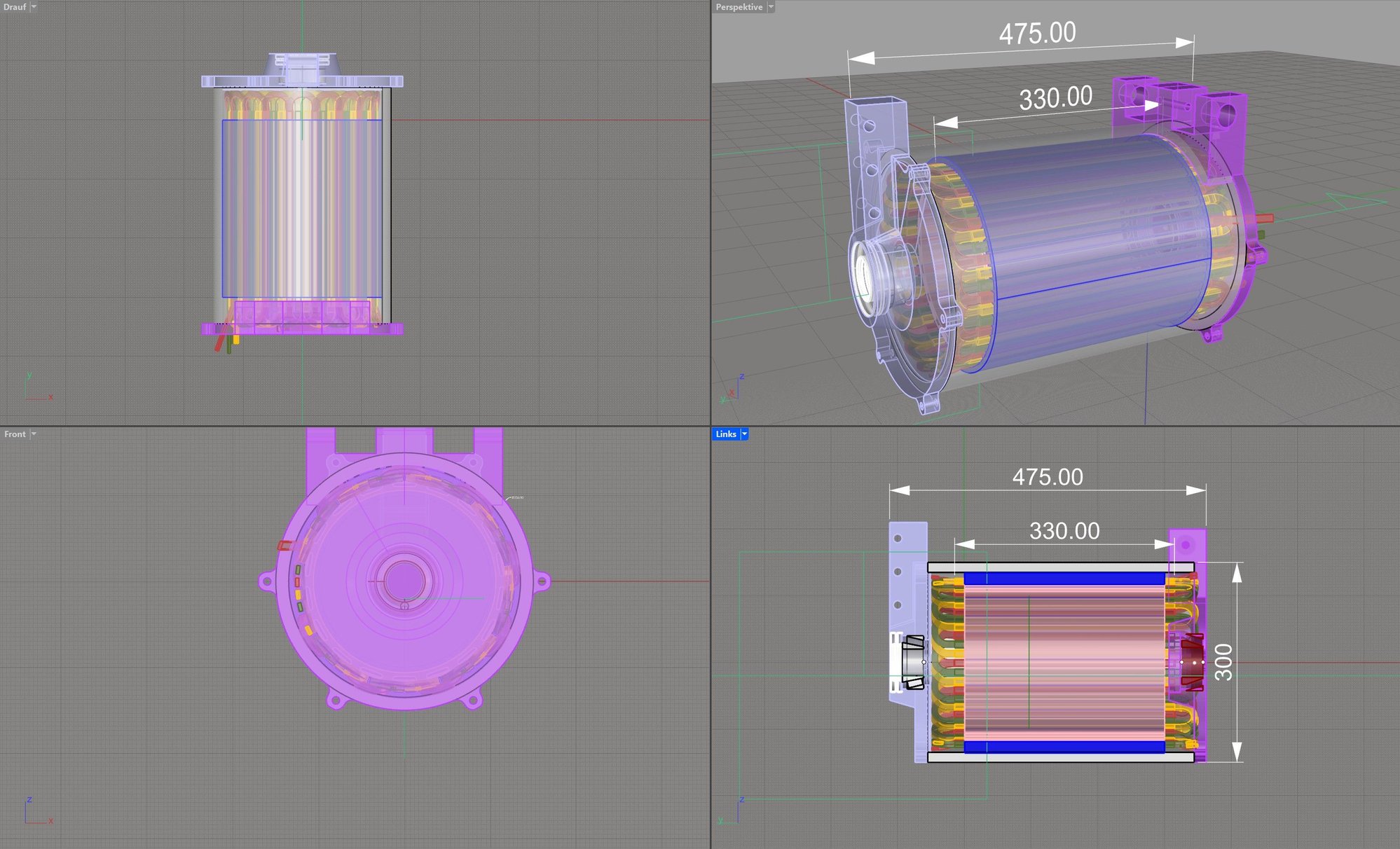

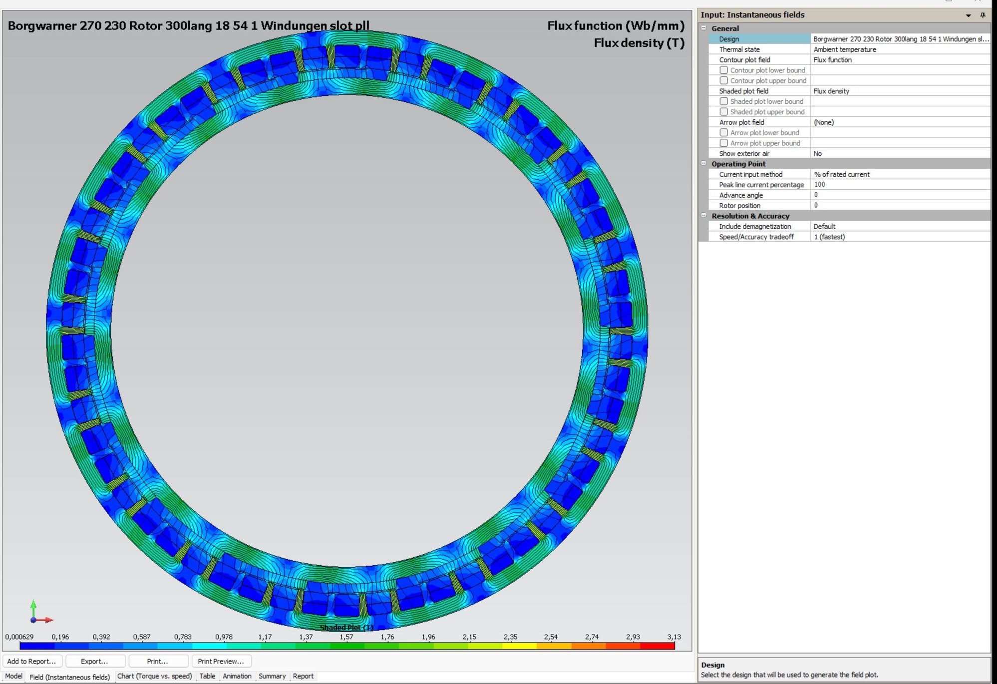

The controller I mentioned was a Sevcon Size 10 but as Sevcon belongs to Borgwarner it would be maybe possible to get the SiC-PP with up to 900V and 740 Arms. I will put in a picture of it. Sutphen 30 wanted to know what motor I will use. I will also attach some pictures, it will be a DIY motor with the Borgwarner SiC-PP it could bring up to 1600 Nm and 3500 rpm. 586 hp in theore.

I see the Hi-power inverter can go up to 740 amps,,whats the continuous amp rating?
I take it this motor you want to use is cheaper than a couple of axial flux motors ganged together?
