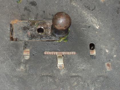

HEre is my Hideaway it is great
clearcut3 is offline

Here it is out. If you have never had one before keep it greased or else it will be a pain in the arse eventually.

Is that the hide away from Draw-Tite? I understand how the ball retracts, but how do you get to the loops for the safety chains?
