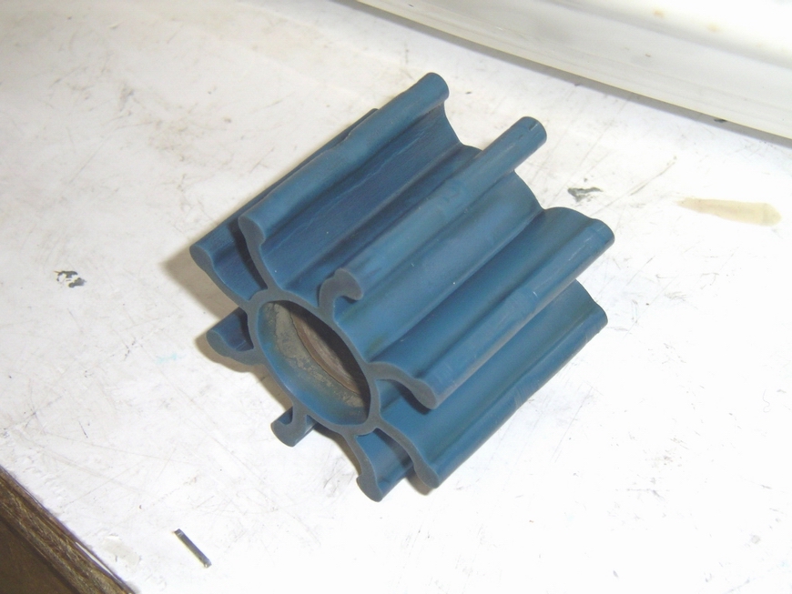

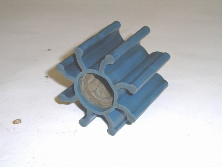

Default Re: Impeller Question
Originally Posted by NJgr8ful
RLW ... what GLOBE impeller # is that ... #2000??
Yes, it is a 2000.
Here are some pics of the same impeller pictured above with 67 hours of use. It has been in the boat for three years.
2003 = 25 hours (old blower motor)
2004 = 15 hours (new 540)
2005 = 27 hours (not quite as new 540)
Yeah, I know, I don't get out much.
Needless to say (and since I had it apart), I replaced the impeller with a new Globe Blue. The housing looked good and the wearplates were fine.
I am still using the old two piece style housing.
I use the key and so should you. I believe it was a Merc part #.
It moves axially on the shaft, but has no apparent effect on the wearplates.
