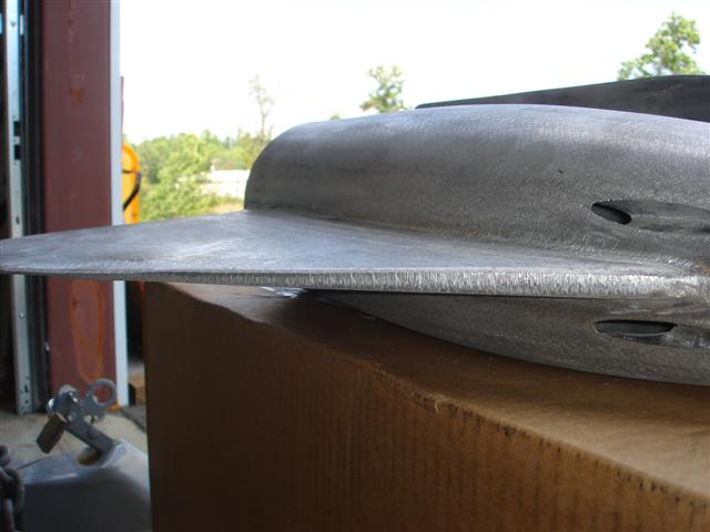

Pics of new lowers.Looks like a standard bravo lower to me.Cases look really rough and the skeg is about 1/2" thick.I sure hope the lowers work.

Ruff looking

Watch your water preasure with those new lowers, I noticed in post 26? there are two pickups. I kept loosing head gaskets with a set of imco's like those. Installed merc preasure relief valves & took care of the problem.
My spare is a standard length crescent lower from bmax. (looks just like that) I doubt you will gain speed. only the shorty gained speed for me.

smooth it down a bit, then polish it. ive got a pair to put on my warlock cat but im thinking of going to imcos instead. so these three may be forsale soon, dont want to put them on and go slower.
