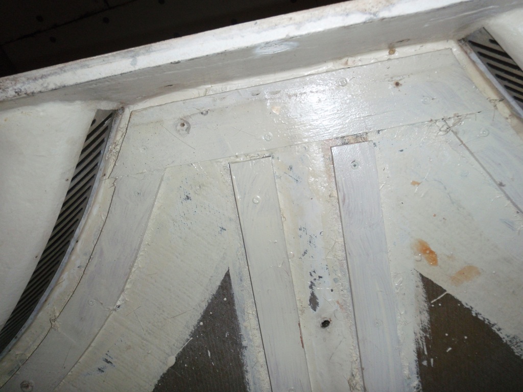

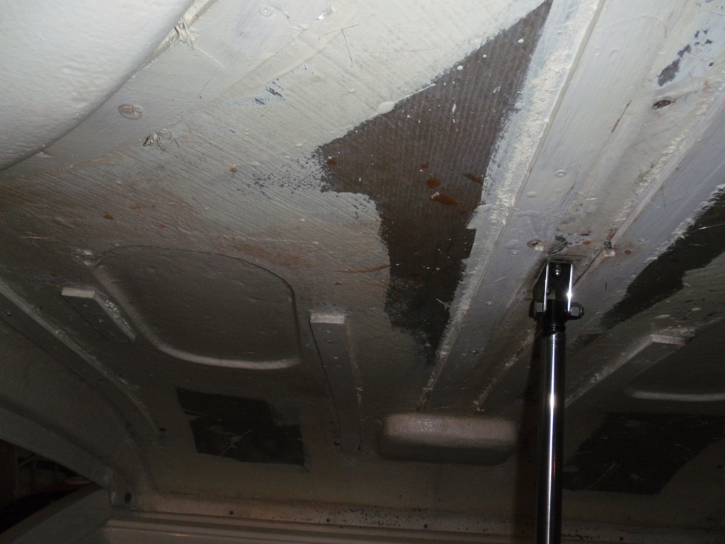

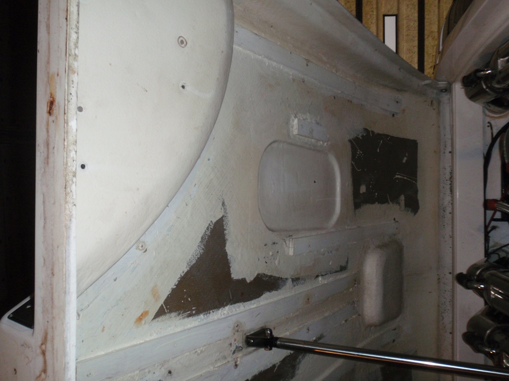

I pulled the mirror of my '98 Hustler Slingshot last month, had to take it off to get to the sun pad. Mine had 1 1/2"x 3/4" furring strips glassed to the under hatch and screwed to the hatch. The acrylic mirror had a luan subflooring glued to the acrylic. The mirror had holes drilled into it, rubber grommets around the holes with a screw holding it to the furring strips. This came from that factory this way. Attachment 413355
