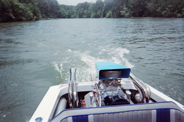

You can ask around until you find someone to tell you they have put a blower on a 496 and it hasn't blow up-yet. But that will not stop it from coming apart. I have been running superchargers on boats since the mid 80's and have blown up a few engines and melted a few pistons along the way. You should see the wall of broken parts I have accumulated over the years and the one thing I can guarantee is, the better the parts you start with, the longer and more trouble free your project will be. Blowers are not magic, they just increase the volumetric efficiency of a motor and make it burn more gas, thus make more hp by forcing more air/fuel mixture in a cylinder before the spark plug lights it off. If you want to put a blower on a stock motor and turn the boost way down and not run it hard, it will last a little while. But if you spend the money on a supercharger to go fast and then you baby it, you are a better man than I. I have extreme motors and boats because I like to run the crap out of them. If you don't, why have a blower? For looks? I know it seems easy and cheap to just bolt a Whipple on your engine, but most likely you will not be happy with the results. You can sell your 496 for 6K to 8K if it is in good shape and put a 454 in there with good parts, (not top of the line but good) that will be a much more dependable motor that you can actually use normally and make 650hp.
Attachment 440237
Attachment 440238
One of the first boats I supercharged
