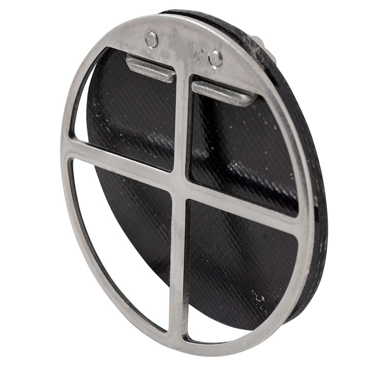

So I bought new hardin tips with silent seal internal flappers and the advertisement says how they are so much quieter than the rubber wrapped internal steel flappers.
Well, I fired the thing up and I thought the rods were gonna come flying out of my motor, after freaking out I finally realized the flappers were causing all of the noise. I pulled out the flappers and sure enough she was all quiet again.
Basically anytime the motor is below 1100rpm these things are slapping away like crazy inside the tips… so is there anyway to keep these flappers in there but keep them from making all this noise??

well not maybe quite a rod knocking noise, but its a "whap whap whap whap" noise. put it like this, my wife even noticed and said whats making all that noise!! like i said once it clears 1100rpm its all quiet as can be.

what was the rpm on your test motor in the video? as i said, mine only make noise 1000rpm and less. the noise is from the rubber flap sucking back up against the steel cage. i have silent choice, i can fire up my boat up on the trailer in my driveway and have the rpm at say 850 rpm and hear the whap whap whap from the tips all day long, as soon as i hit the silent choice button that noise is totally gone, open the through hull again and the whap whap whap is right back.

Glad I found this post, I just installed new tips with the flappers like in the picture and I developed a knocking noise. I thought I spun a bearing,oil filter is clean ,oil pressure is good and it must be the flapper!
