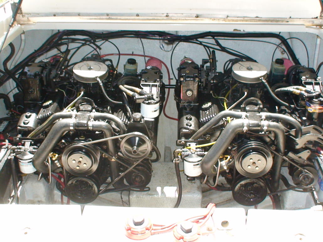

Did the same thing...
2 Attachment(s)
Attachment 453550I upgraded my twin 350s from stock intakes and 2 bl Rochester carbs to Edelbrock Performers (2104) and Edelbrock 600 cfm carbs (1409). Saw about 4 mph improvement. They worked right out of the box. Here's the before and after shots...
