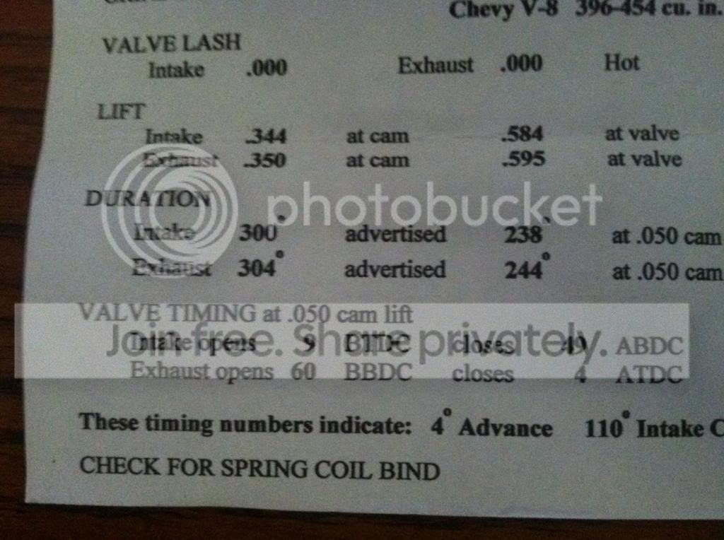

A scuffed piston in a .030 over 454 led to some knocking so I guess Im due for a rebuild. Currently has 088 rectangle heads and an unknown hyd flat tappet cam. Dual plane alum manifold, Q-jet and stainless marine exh. I'm thinking of building a 496 with this cam. What do you guys think?

Just be careful and make sure you have an exhaust system that won't present reversion problems for you. I'm sure the cam will make fine power as if you ask ten different people you might get ten different answers. But your durations up in the 240's at .050 will definitely wreak havoc with many brands of manifold systems with short risers. Best regards
Rectangle port heads, cam with 240* @ .050, nearly .600 lift, and 110* LSA, and they are running what appears to be a stock Merc intake and a Q-jet? Just seems to be a lot of cam and heads for 750 cfm - unless the carb has been reworked considerably.
