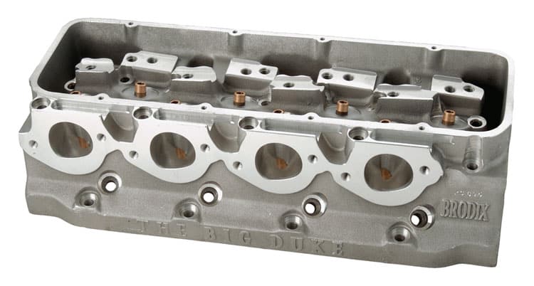

Want a much better exhaust port design?
You can, but you'll have to change pistons, rocker arms, pushrods, valve covers, intake, headers, and etc, etc, etc.
http://www.brodix.com/wp-content/gal...03_exhaust.jpg

and don,t forget the guide work every 50 hrs.
