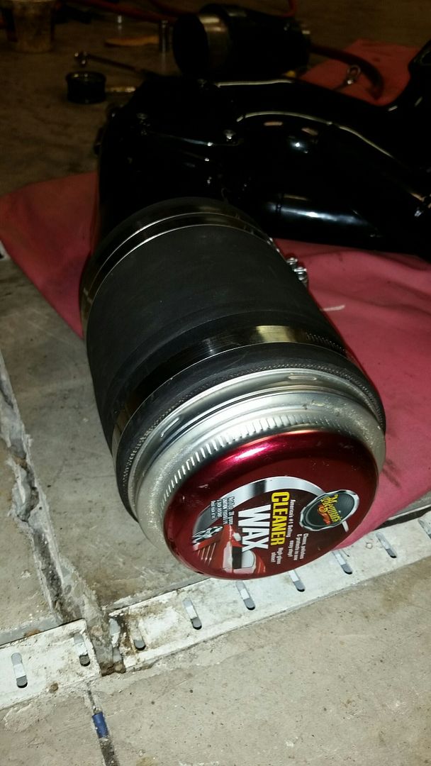

What I do is cut a piece of the exhaust hose about 1/2 inch long and then cut a notch out of it so it is just barely bigger than the inner pipe. I then clamp the 5 inch exhaust hose to the header where it is normally connected and then using another clamp - clamp down on the 5 inch hose where the cut off piece of hose in installed on the inner pipe. IF done right this will seal off where the water comes out of the header. Then just hook the hose to the water inlet manifold and turn the water on slowly. If there is a leak the water will come out of the inner tubes. Cheap easy way to water pressure test. And water shows up the leak much easier than air.
Budman II 06-12-2015 09:41 PM
I think I figured out a way to test it with water. I left the plug in the 4-inch collector inner pipe to seal that off, and slipped the 5-inch rubber hose over the end of it. Then I hunted around the shop until I found something round about the same diameter. I finally found a tin of wax of all things. Plugged it with that and tightened down the clamps. Tomorrow when I have some daylight I will hook the hose up to the water distribution manifold going into the primary tubes and see how it does. I suppose I might have to leave the "cap" or wax tin off the collector at first to allow the jackets to fill up with water, right?
http://i1224.photobucket.com/albums/...eader-test.jpg
FWIW, when I took my flange off for the air test it was still holding some air. At this point I am starting to doubt that I have a header leak.
Budman II 06-13-2015 10:48 AM
Pressure tested with water this morning. Was not a perfect test because I did not have a pressure gauge and I could not get a perfect seal at the end of the exhaust hose, but I am confident that I was able to build at least 25-30 PSI of pressure. No leaks. Hmmm.
I'm tempted just to put the damned thing together and run it at this point. Maybe pull the #1 spark plug after running and look for some moisture. At this point I am confident that the deposits in the exhaust port were not from a header leak.
