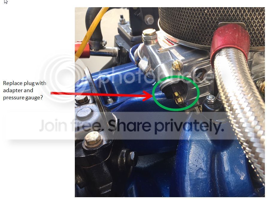

For the fuel pressure gauge, is the plug in the unused fuel inlet on the port side an okay place to hook into or do I need to be plumbed into the supply line?
