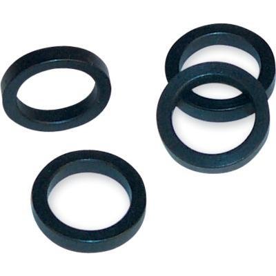

Hard to compare small block stuff with big block stuff. Under $200 you can use the GM Performance lifters and run your SBC like a buzz saw. Much lower valve/keeper weight, much lower spring weight, and pretty straight valvetrain.
I forgot to mention the other week cause we where without power and internet for 6 days (brutal massive storm), but just before then I found a company that makes limiters for hyd lifters. :)
Harley uses, on many engines, the SBC lifter. :) So, leave it to S&S cycle to make it. These should fit in the BBC GM HR lifter too.
S&S Cycle Hyrdralic Lifter Limited Travel Spacer 33-5338
Link: http://a.co/7Ojscl4
https://images-na.ssl-images-amazon....1t0OS9KTXL.jpg
Hang Time 27 04-04-2017 04:48 PM
Great find! Sure looks like a simple way to do it.

mike tkach 11-28-2018 10:20 PM
i used a set in a 509 that got the snot ran out of it for the summer the owner ran it,so far so good.

Diamond Dave 11-29-2018 07:31 PM
Have some of these in my 509's. I have about 60 or so hours now on them so far so good.

snapmorgan 11-30-2018 12:12 PM
So far, mine are doing great. I have used them in the last 4 engines that I built, but probably less than 200 hrs combined on all 4 engines. The last two were 548's that we dyno'd to 6300rpm with no issues. They had pretty big cams and pretty stiff springs.
Baja Rooster 11-30-2018 12:27 PM
FWIW, I ran my stock GM lifters with Eddie Young’s blessing, but they measure out at the exact height of these short travel lifters so you can switch them out without reinventing the valve train.
