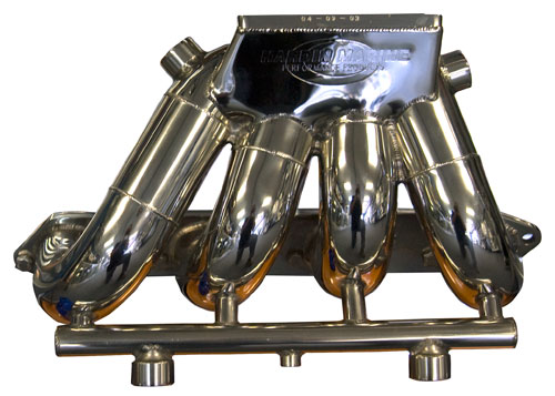

Cyclone "Shorty Header" - Hardin Marine
Attachment 570457
What kind of life span can one expect from the Cyclones? My motors were built in 2009, at that time the Cyclones were new. Now based on what Rooster said I'm slightly paranoid..
