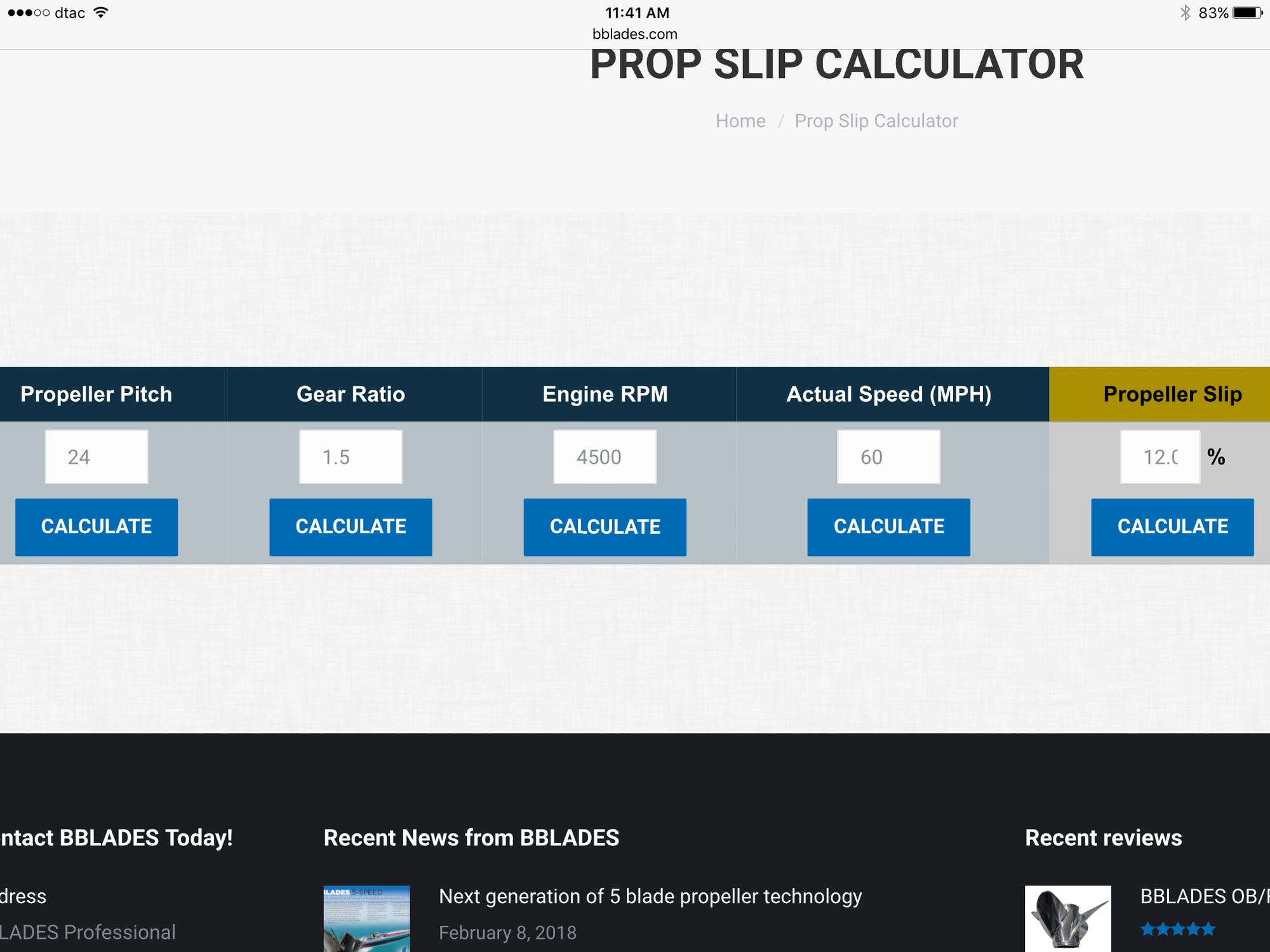

__Sleek__ 04-07-2018 10:52 PM
WOT Full tank of gas 4500 RPM @ 60 Mph about 95F trimmed below half and okay water.
rak rua 04-07-2018 11:45 PM
Prop slip at 12% is good but your rpm's are down. Others on here know more about props, hopefully they'll have some suggestions.

Boatally Insane 04-08-2018 10:03 AM
If you haven't found it already, here is the BBlades slip calculator
BBLADES - Prop Slip Calculator
https://cimg2.ibsrv.net/gimg/www.off...8d74e49b6e.png
Bravo props are 1 pitch light.. a 24 Bravo I is actually a 23 pitch prop...
