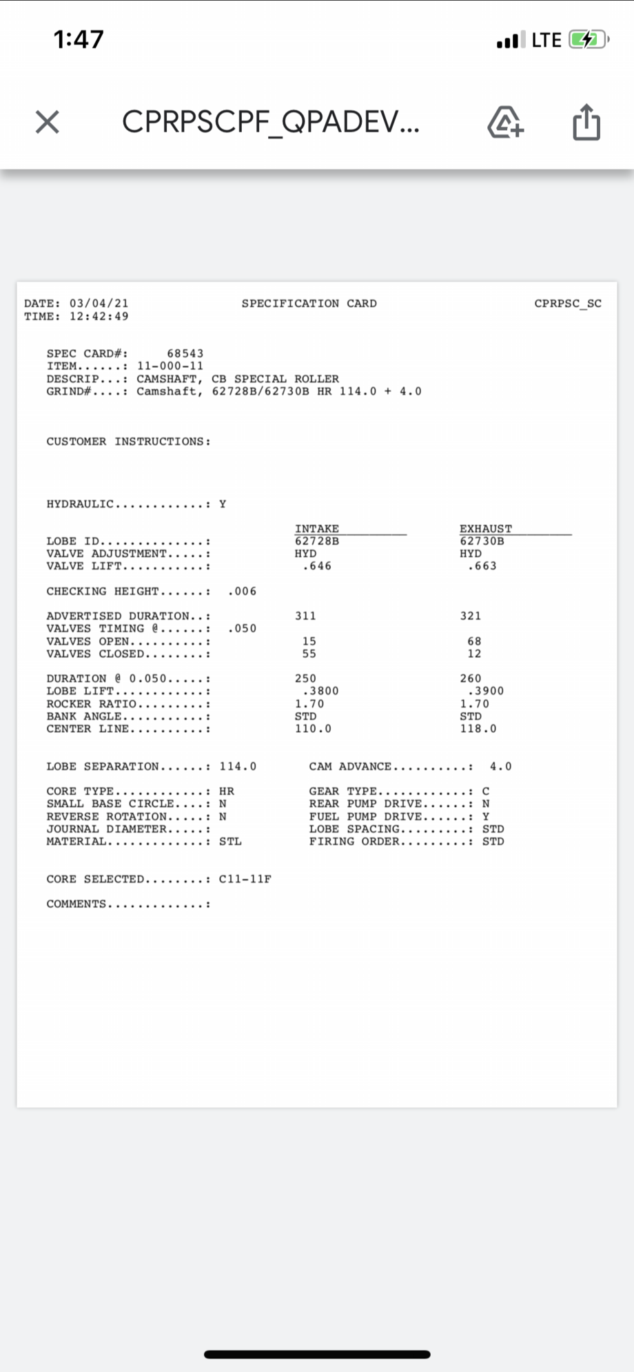

He just called me, All is good. As far as I know, the builds have been flawless. The cams were a custom grind from Lunati. 250. [email protected] .646 .663 lift. The tech that I talked to at Lunati called them "Haxby Specials"
getrdunn 03-23-2021 01:23 PM
Tks. That’s the same exact grind Lunati spec’d for my 565’s.

Mike at Lunati I spoke with a couple times. That’s his favorite go to cam for offshore 540 plus CI. He use to work for comp and very knowledgeable and into offshore himself. Just wanted to pass on!
