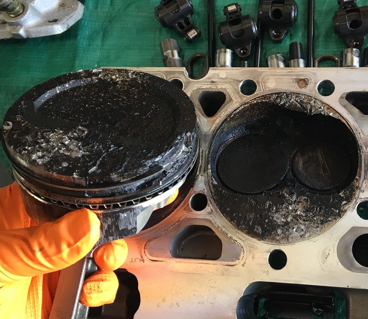

Originally Posted by BillK (Post 4628553)
Jim,
Exactly how did the ring fail ? I wonder if it stuck in the bore and pulled the top ring land off the piston. Any pictures of the failure ?
I would think that 36 degrees of timing is pushing it unless everything is just about perfect as far as fuel goes.
The Scat crank should not have been a problem. I wonder if the cracks are an indication of detonation ? How did the rod bearings look, especially the upper half ?
I agree that internal balance is definitely better in this case.
Even though I do balancing if I was doing this I would have Crower balance the crank. Just give them the bob weight number.
600 cfm carb definitely needs to go.
Just thinking out loud :)
See attached image of the piston and head. (site won't let me upload images until I have 10 posts!)
The two small cracks were almost impossible to see even with the magnaflux, and that was on #1 trow. Didn't see any indication of detonation on #1 piston. I wonder if the cracks were there before install? And the rod bearings looked decent considering the trash that was embedded in them.
And yes I am having Crower do an internal balance once I get the pistons from JE and get the bob weight.
And the consensus all around seems to be bigger carb.
https://cimg3.ibsrv.net/gimg/www.off...b43ef10856.jpg
And thanks everyone for all the input, much appreciated.

See piston image above
GPM 05-27-2018 03:37 PM
What a mess, can't say I haven't been there. Any chance you had a vacuum leak at the intake runner, or head gasket leaking between the cylinders that over heated that piston.
BillK 05-27-2018 07:29 PM
Originally Posted by jmm4jmc (Post 4628636)
See attached image of the piston and head..
You cannot find a better picture of detonation damage. The ring did not fail. The piston came apart due to detonation.
