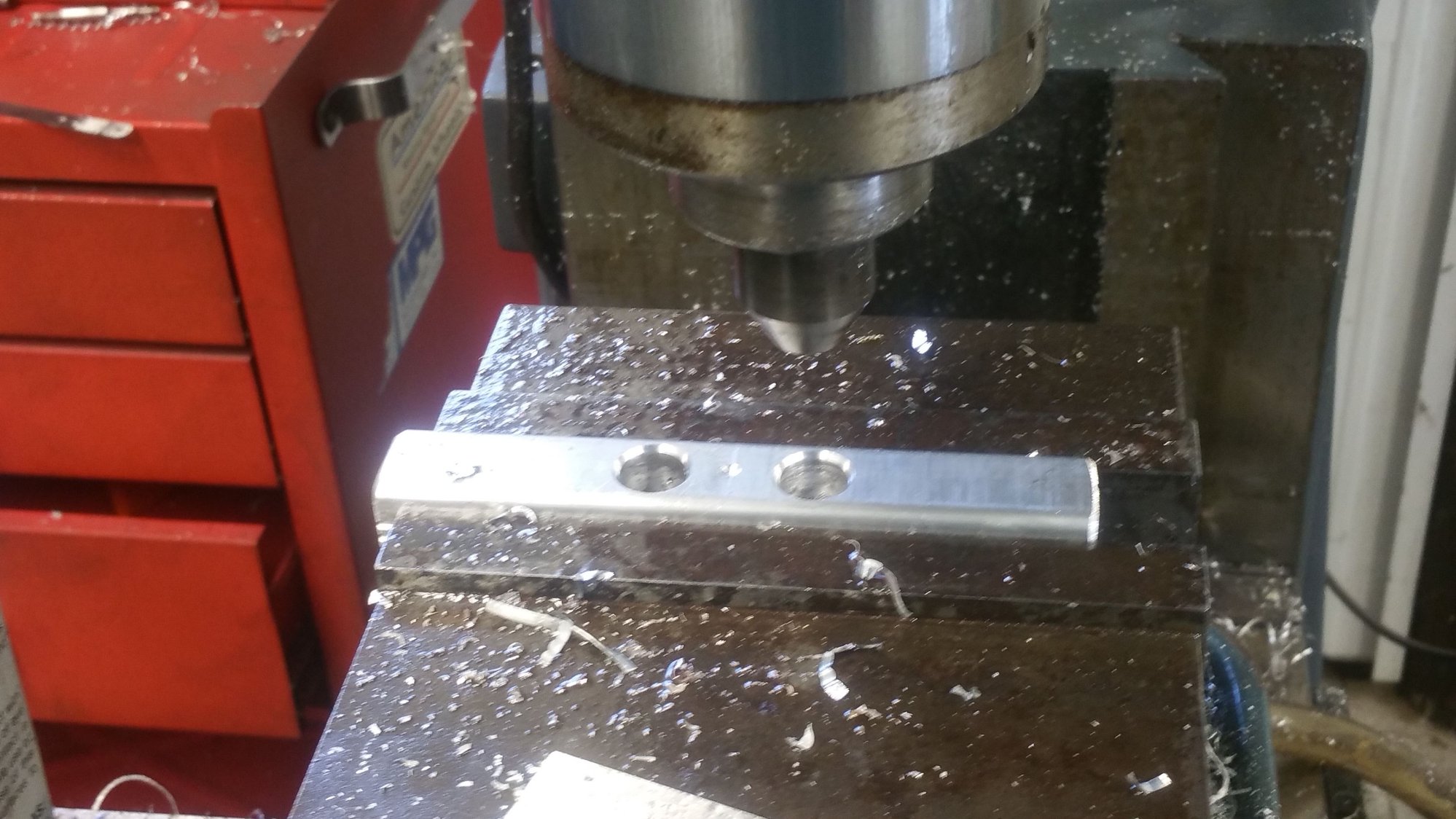

i did not bore notch it, yes, the tune will be waaaay off after boosting it. Making fuel rails today for both whipples aux injectors https://cimg8.ibsrv.net/gimg/www.off...5fc99c3ed0.jpg

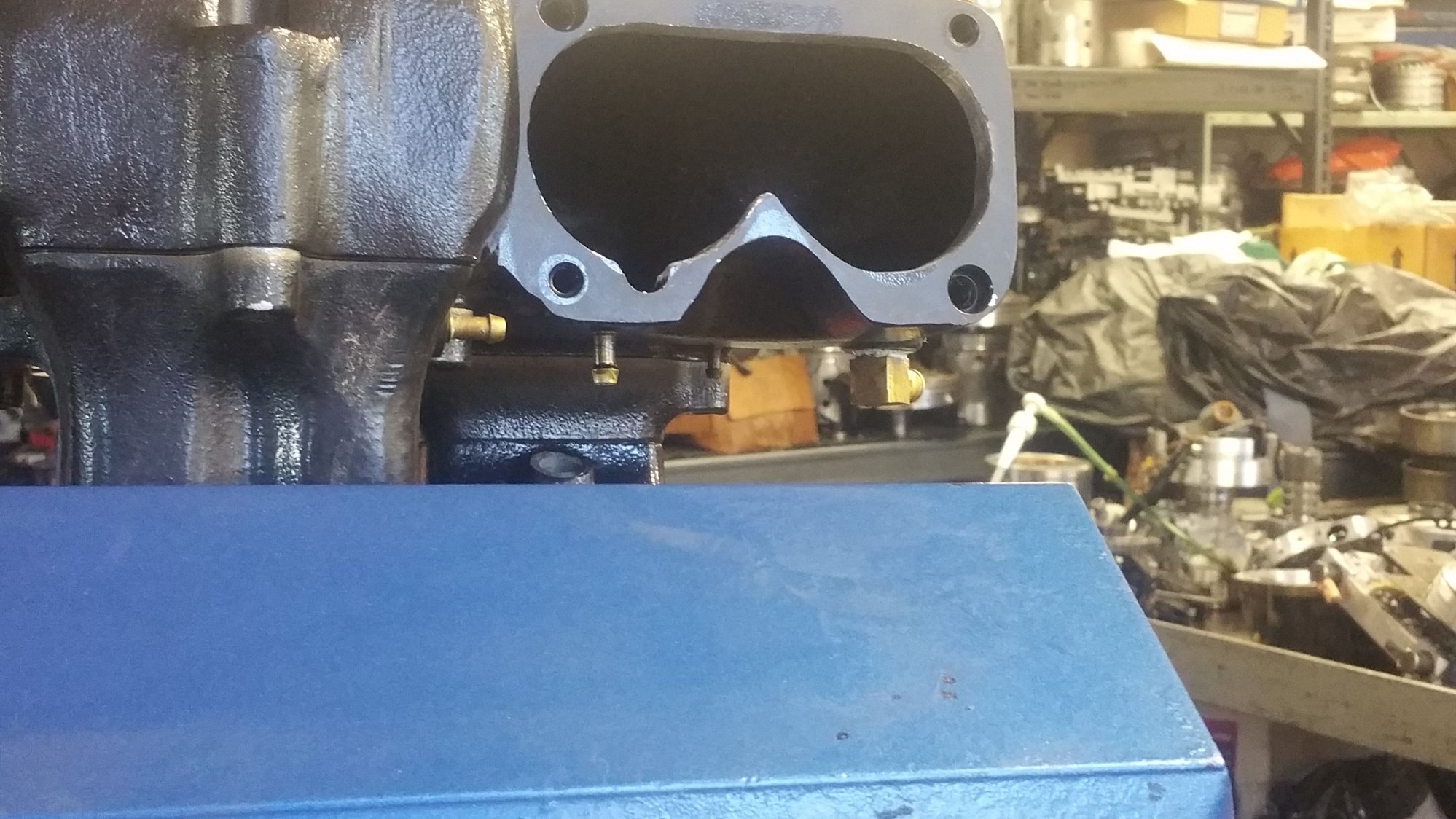

a stock tb is twin 60.mm, the tpis is twin 68mm. Years ago i had 3 of them bored to twin 65 mm, in back to back dyno testing on a 540 i saw 12 hp or so, then more yet w the twin 68. i did extensive testing two years ago on a mildly modded 502 mpi,i dont remember the exact numbers but i tried 3 different tbdl's and a ton of flame arrestors, I posted all the results on here too.
the tpis tb is actually bigger than stock plenum opening, first time i tried running one i didnt bother to port the plenum and it created problems. Heres pic of one modded 90% of way for the 68 mm tb, i had roughed this one in and still had to pretty it up.
I didn't open up my cutomers 454 plenums for the tb test since i wanted the plenum as intact as possible when we hang the ehipple sidemounts on so i whittled up a spare 502 plenumhttps://cimg6.ibsrv.net/gimg/www.off...eb67a31f52.jpg
