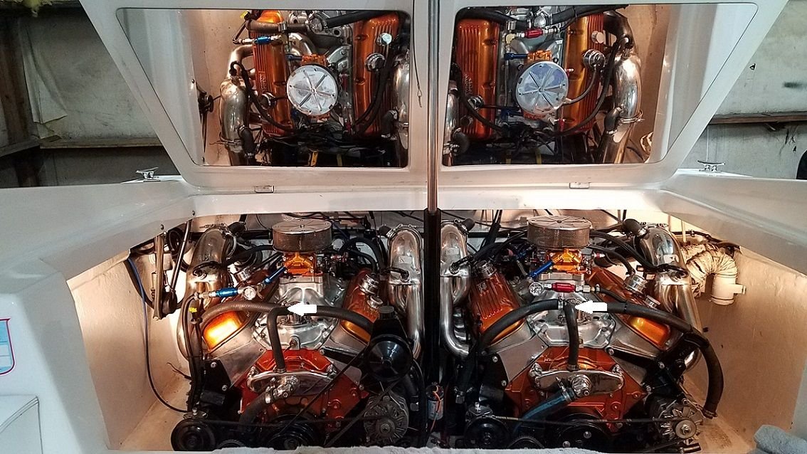

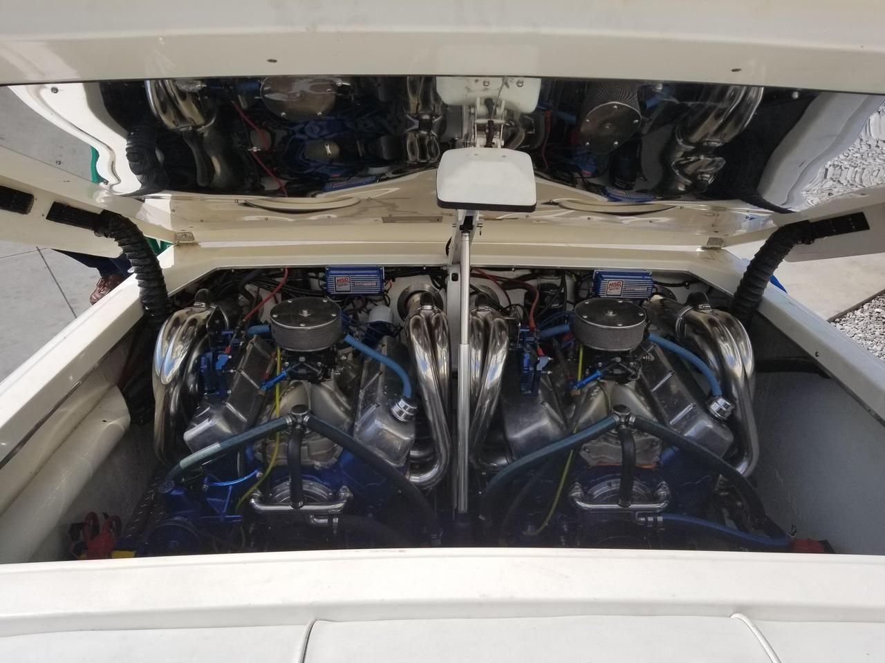

The setup is as follows:
Hardin stainless crossover and thermostat housing, no thermostat, restrictor plate with 1/2" hole instead of thermostat.
Stainless headers (CMI, I think?).

Rookie 07-13-2018 07:21 PM

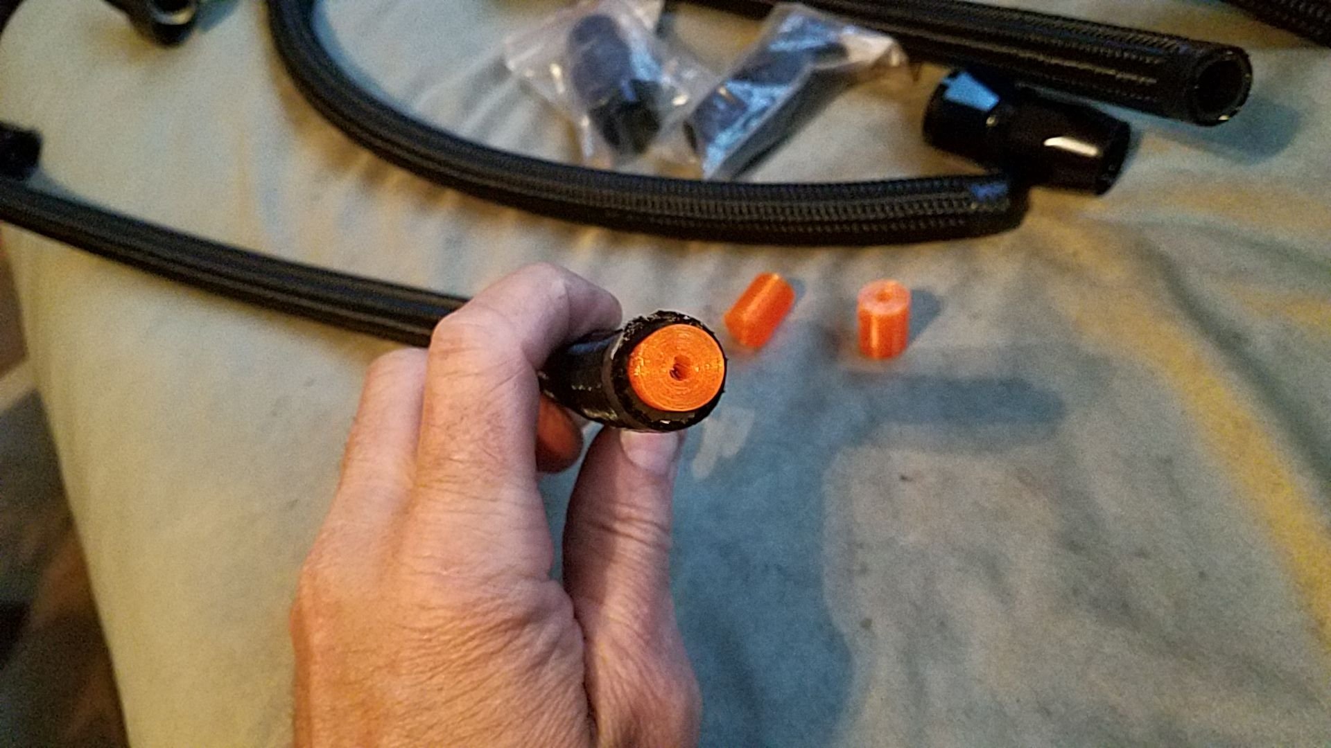

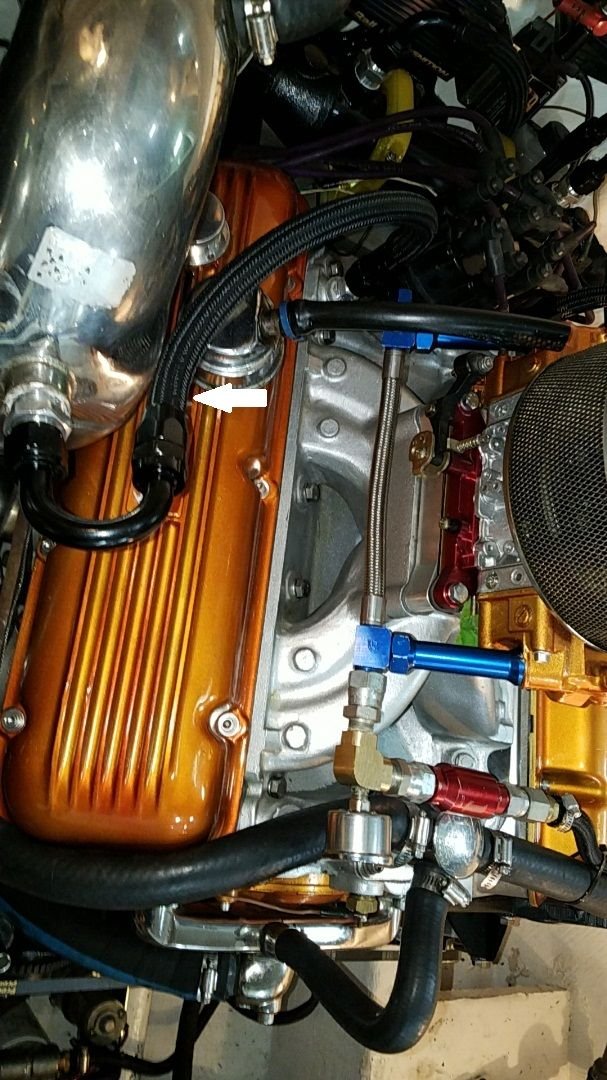

All your water is bypassing the engine going through the bypass. I had to add a flow restrictor to mine. I 3D printed some restrictors and then I drill them out a little bit to achieve proprer pressure. A piece of stainless round stock with a 1/4" whole worked on my last setup. I put them right before the thermostat housing (arrow pointing) and drill them out with a cordless drill on the water. This is the setup on my new engines this year. I also have them in the back of my intakes that feed water to my exhaust. I have about 2-3 psi at idle and 20 psi at top RPM.

mike tkach 07-13-2018 09:29 PM
the water will always follow the path with the least amount of resistance.it is easier to go through the bypass than through the block,espically the reducing washer in the t stat housing.

ancho 07-26-2018 08:49 PM
Update: I installed restrictors in the crossover bypass hoses. This brought the effective diameter down from approximately 3/4" to 1/2". On a test run today, I saw NO wild fluctuations of water temperature. At idle the temps are 125-130, and when running at 3500-4000 rpm for a few minutes the temps were 150-160 (oil temps 210-220).
