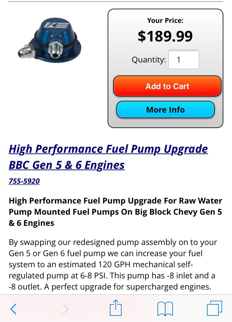

https://cimg1.ibsrv.net/gimg/www.off...9f272ba82.jpeg
The pump is actually only sold as the bottom half for this purpose. I’m looking into gasganinch to help seal it, reassemble, and give it one more shot.
BUP 10-18-2018 12:22 PM
I have these as well but always wondered on the claims of output fuel flow ?

I used Permatex Aviation gasket sealer as I have that laying around and used the process lined out in post #12 and give that a shot and will report the results. Thanks BUP.
Baja Rooster 10-19-2018 04:11 PM
After trying everything with zero luck I stuck the 15 year old Holley back on and it pumped like a champ. $300 in parts and fittings and worthless.
