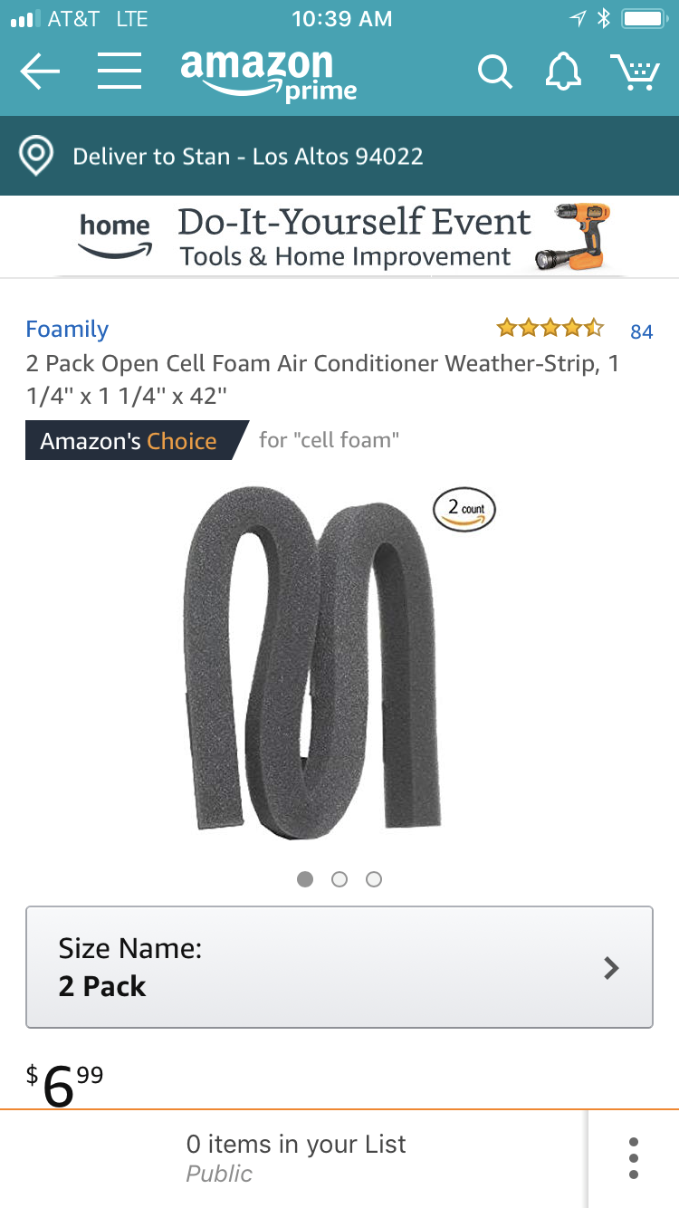

How about shoving some open cell foam in there to see if it makes a difference? It sounds like you may end up cutting in some side vents?
https://cimg7.ibsrv.net/gimg/www.off...f4c3f52ecc.png
