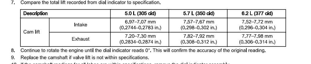

Dispelling the myth that a .450/.465 cam was never installed into a 5.7 (350) Mercruiser. This is straight from the manual that Mercury sent me. Notice that the 5.7 and 6.2 have the same specs on lift even though the part numbers on the cams are different. I suspect that the 6.2 has more duration but they were stuck at .465 lift with the factory Vortec limitations
https://cimg5.ibsrv.net/gimg/www.off...be44d8f0a1.jpg
