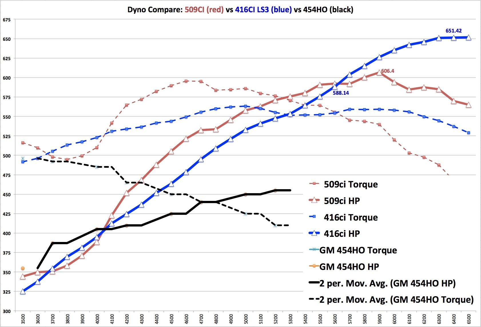

242LS 03-18-2019 07:25 PM
I took MILD THUNDER's 454HO chart, eyeballed the actual numbers and plotted against my LS3 and 509/AFRs/cam (the LS looks just fine for torque now):
https://cimg4.ibsrv.net/gimg/www.off...7c5da20cd.jpeg
MILD THUNDER 03-18-2019 07:30 PM
The LS3 crate is 10.7:1 static, where the 454HO is 8.75:1. I can see where the big block would shine , in the lower rpm and acceleration department.

mggdoors 03-18-2019 10:14 PM
