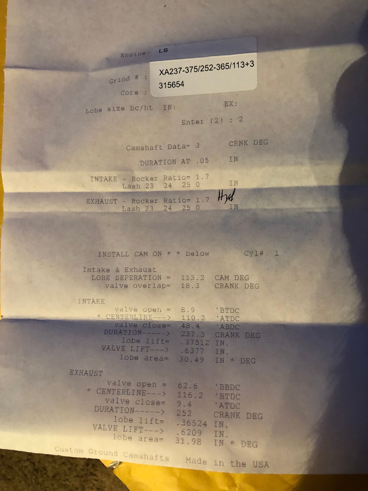

Cams ordered. 237/252 113+3 .637/.621 lift. Should be a fun comparison. Could have went with much more radical setup but this should take the cake while still working well with future modifications
That's a big swing. Will be great to see the difference.

Yep. From one end of the spectrum straight to the other. I was actually going to go with another cam but figured the comparison would be more valid this way, although I did adjust the lsa. Same icl. Same ivo ivc.
