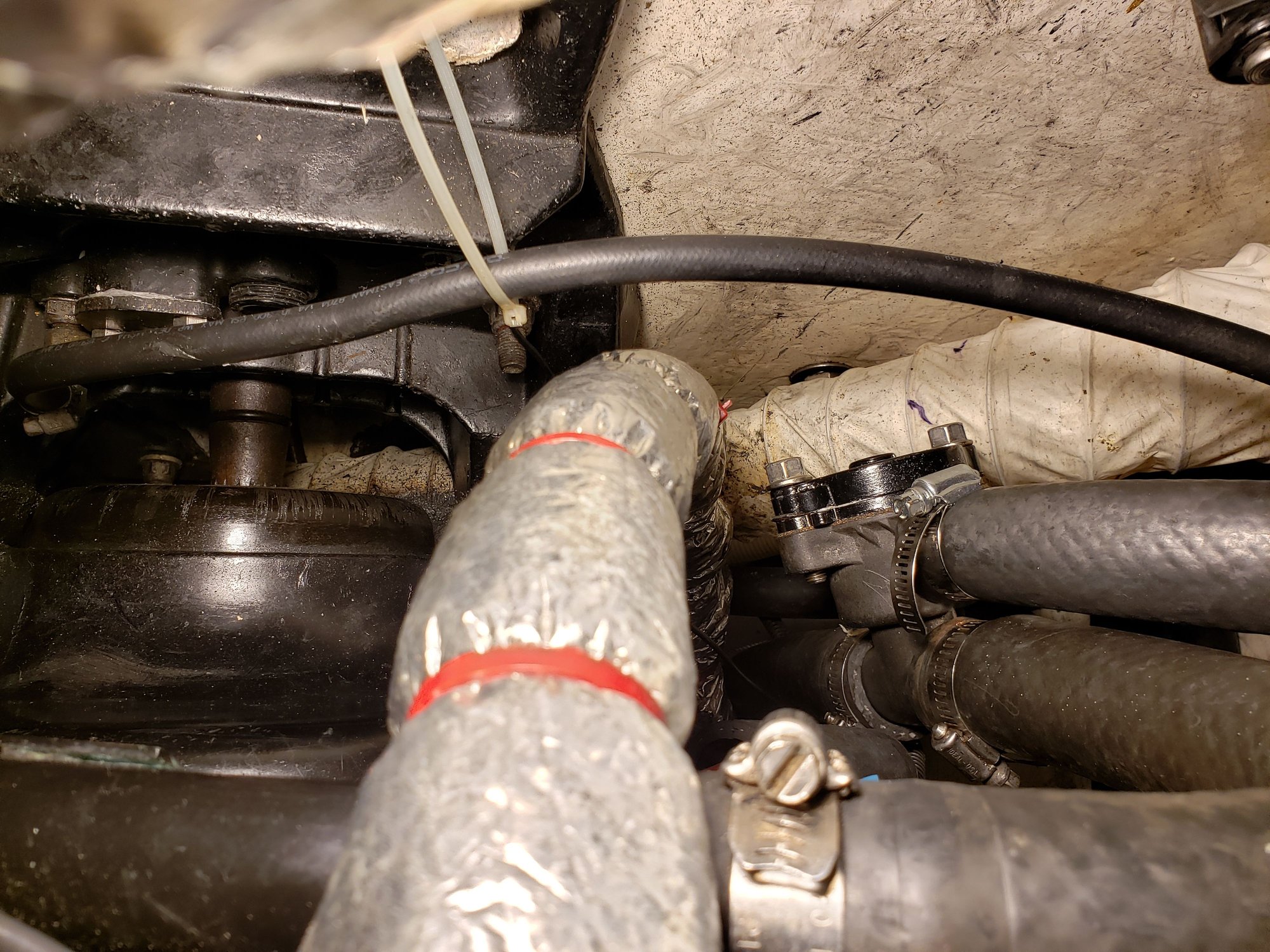

Where did you place the the PRV? I have pipes across the back of each motor that replaced the 420 oil coolers (just after the trans cooler and before th 502 oil cooler). Is that a good spot to add them?
Thanks again for posting that link!
Cap'm Kurt 03-16-2019 12:44 PM
I put it downstream of the PSteering cooler, and before the cool fuel exchanger. Rear port side of motor. The 1" dump hose just goes outside the boat with a thru hull fitting. In my case the boat had the fittings already, next to the bilge pump fitting.
Remember these are not just pressure regulators with one inlet, one outlet. It is a Tee. These let the water go straight thru, wide open fitting. There is a tee that dumps water thru the 3rd side fitting that needs to go overboard. I guess this way if it breaks and closes shut you still have your original water pressure.
Same here on never checking the block water pressure. i never would have started checking it if i hadn't seen all the corrosion below both heads on both motors. It doesn't take a whole lot of pressure to move a lot of water.
I will go see if i can get a pic.
Cap'm Kurt 03-16-2019 01:08 PM
https://cimg5.ibsrv.net/gimg/www.off...97fd9b29f6.jpg

My PRVs are like the Mercury part but without the diaphragm. It’s a 3-way that puts excess water overboard. I’ll add the dumps to the transom more than likely.
